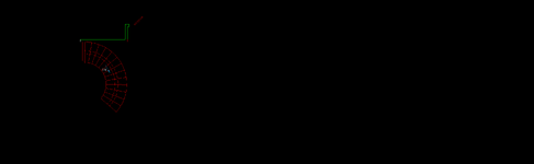

I am designing a HSS beam used for a residential stair. It will be a single HSS stringer cold bent to an approximate 4ft inside radius and span from ground floor to 2nd floor. I have never designed a steel beam that is bent in 2 directions like this is, so I have a few questions.
Are any of the steels physical properties changed after bending, such as yield stress?
IF anyone has designed this type of beam what would you suggest that I design each of the end supports for? Fully restrained both ends, pinned one end and fully restrained the other?
Or any information or direction as to where I find information about designing members like that would be greatly appreciated.
Sorry for the very basic plan, but this is what the architect provided:(

I like the following for a system likely being integrated into light frame construction. If you're actually tying into heavy concrete or steel, additional restraint might be plausible based on stiffness and connection competency. Longitudinal and transverse refer to the stringer itself as it enters the connections.
Bottom
Plan view longitudinal = pin
Plan view transverse = pin
Vertical = pin
Rotation all 3 Axes = free
Vertical = free
What I described above won't actually be in static equilibrium. You'll need some form(s) of rotational restraint I think. I imagine that's some combination of:
a) Strong axis moment top and bottom and/or;
b) Torsion top and or bottom.
Again, much depends on what your supports are. I see steel support beams in your future.
