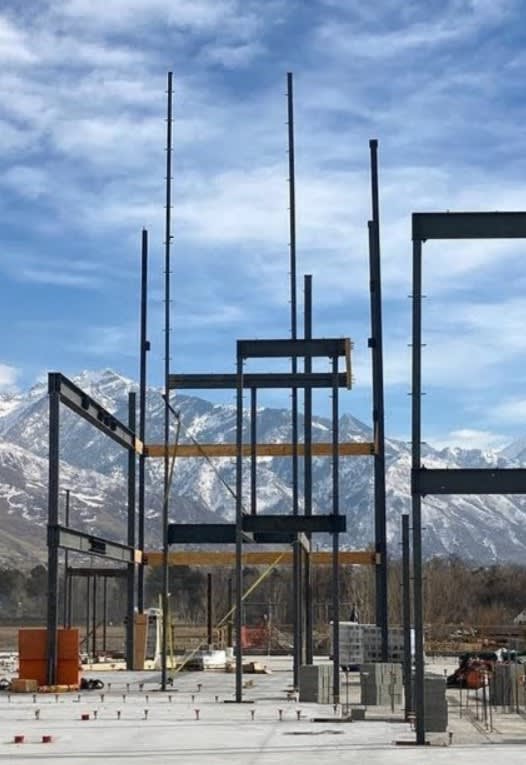

Here's what I would assume to be a code-compliant spindly one for you
(I was acting as chief passerby on this project).
This always makes me remember the OSHA column vs post anchorage thing. Column is anything over 300 lb self weight I think? And requires 4 anchorbolts and must be checked for erection loads. Which is also a 300 lb load 18" off face of column. To my understanding, that load*distance is supposed to be an ironworker scaling the column. But could be a not-far-off representation of a spindly column, sans the ironworker.

"Means and methods by the contractor. Contractor to ensure stability during erection." ;-)
The columns in your pic are surely thin. There *appears* to be a bunch of plates welded to them (possibly for siding girts?), and so maybe they're not so bad once the full building is up.
