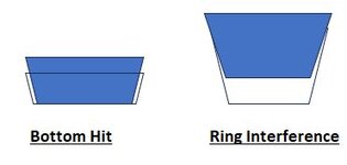

I'm trying to deal with the rebounding action(bounce) of two flat faced steel cylinders striking each other. I'm convincing myself that re-configuring from two flat faces to a 25-30 degree off center line conically tapered end on one cylinder and a corresponding angle female feature on the other will redirect the impact forces and greatly reduce the bounce. Not enough angle to taper lock, but a redirecting of energy as opposed to the 90 degree faces. Does this theory have any validity?

I have a very basic understanding of how the "bounce" is induced. The deformation, though slight in the case of my steel members, resulting in kinetic energy opposite the deformation and thus the rebound (bounce). I'm surmising, but having trouble concluding, that two conical surfaces interfacing would change the direction of the deformation and corresponding kinetic energy ultimately reducing the bounce substantially.

I think that if there is any difference, the alignment of the colliding parts and precision of the surfaces will govern the behavior.
