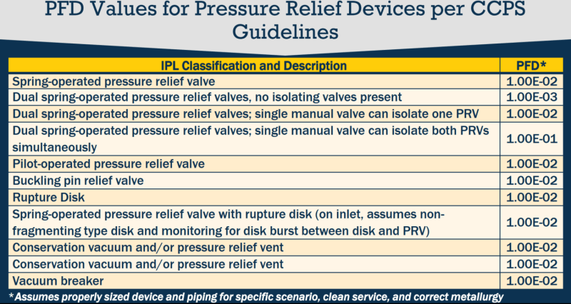

In LOPA we take PSVs as two orders of magnitude reduction, which would equate to a SIL 2.
If a HIPPS system is truly a SIL 3, it would technically be more reliable. However, to achieve SYSTEM-WIDE SIL 3 capability would require some detailed PFD analsys of individual components PFDs. Depending on the system, multiple SIL-3 instruments and decision making processors are likely to be required.
Can you please explain why?
failure on demand SIL2 = 10-2 - 10-3
meanwhile e.g. OREDA PSV FoD = 10-5 - 10-6

A PSV can be lower or higher PFD than an instrumented system, depending on design. System PFD is a statistical collection of individual component PFDs. Usually the instrument/transmitter, connecting line, decision making computer, and final control element/connecting line are considered in the loop analysis.
To my recollection, achieving a SIL 3 system rating requires something like, at minimum, two independent SIL 3 instruments, two independent SIL 3 (maybe SIL 2?) decision making computers, and two independent final control elements that each can fully implement the necessary controls action. The necessary SIL rating on the individual components as well as number of independent loops can be adjusted to meet necessary PFD. Additionally, the inspection frequency for function testing of the interlock loop also alters the PFD calculations.

That is industry standard LOPA failure rate from the Center for Chemical Process Safety. The page you posted has failure to open on demand high-end failures at a mean of 8 failures to open in 10^5 hours of operation. I do not see how that correlates to a PFD of 10^-5 to 10^-6. Nobody in their right mind would expect that kind of PFD; a SIL 4 for a single device is preposterous.
