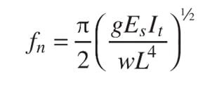

The project specifications say you must use a superimposed dead load of 3 kN/m2 in the vibration analysis? The analysis must be run with the superimposed dead load that will probably be there during a vibration event, not one that has been set for strength/deflection design.
Ma.ahmed said:
but if i did camber to main beam under dead loads of steel members, Can i use the resultant deflection into calculation so natural frequency EQ3.3
No, camber won't make any difference in the natural frequency. The system will vibrate about an equilibrium position that is higher than if the beam wasn't cambered. That has no effect on frequency or acceleration.
Note that the presence of Delta in the natural frequency equation is only an algebraic manipulation to make the frequency equation easier to remember. The natural frequency of a beam or girder is computed using the following equation, which is from Design Guide 11 Chapter 3. w/g is the distributed mass that would be present during vibration. The use of Delta causes never-ending confusion such as this question on camber.
