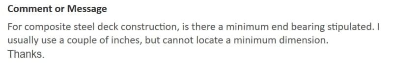

Is there a minimum end bearing value for steel floor deck. I would have thought 2" or something of that ilk, but cannot locate this. Is this a matter for the manufacturer. Canadian practice, and cannot locate anything is CSA Standards or CSSBI Standards.
Thanks, Dik

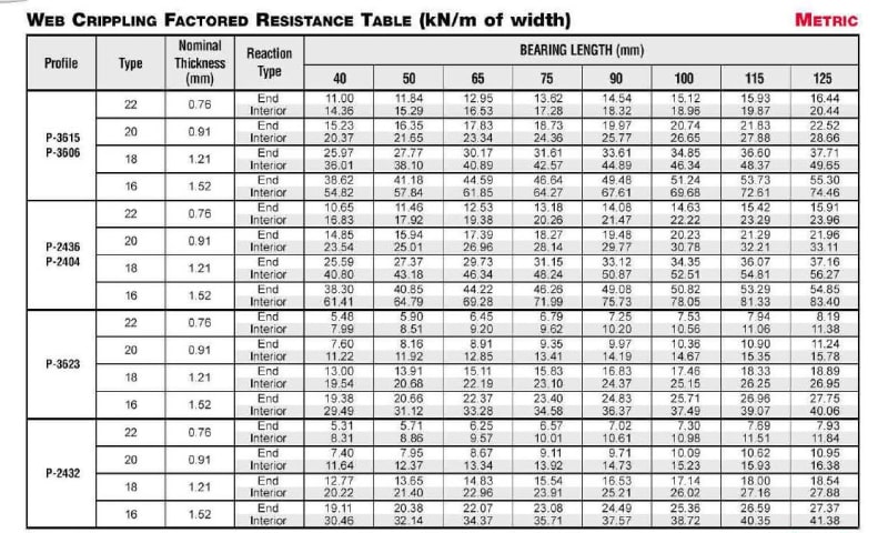

Not sure of the source, but the attachment below from Canam Steel indicates 40mm (1.6") bearing for their P-3615 deck.
But be careful; the Canam Steel Deck catalog provides factored reaction values for 76mm deck of 76mm, 100mm and 140mm bearing, so it cannot always be assumed that 38 mm is adequate.

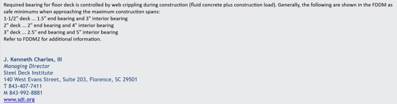

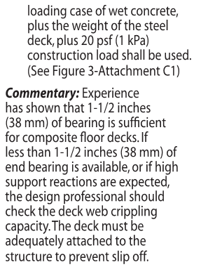

From the SDI, in answer to my question:
and the response:
Great response... I don't know how or if it deals with different gauges; this may be in the reference. Is there anyone that can scan/photograph the relevant part?
Canam lists Web Crippling resistance for several profiles, different gauges and different bearing lengths in their Steel Deck catalog.
Thanks, BART...

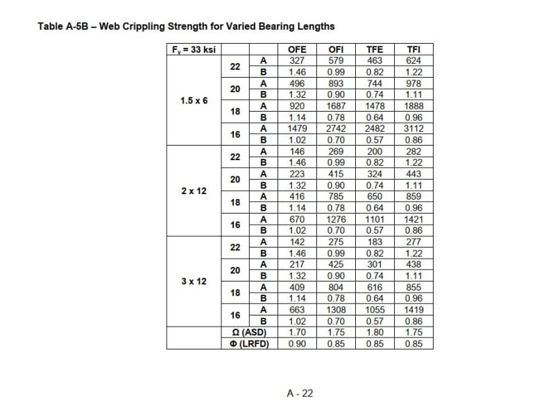

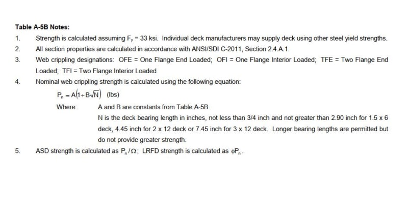

Thanks so much, BART... another SMath program coming up... any idea of how the coefficients A and B are determined? I'd have used a phi factor of 0.85 for all cases.
I haven't a clue! Here is what I found:
