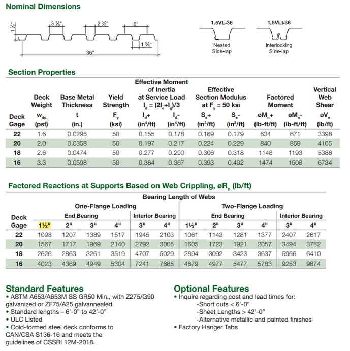

Just heard from Vulcraft:
"The minimum end bearing for our composite deck is 1.5” and it varies based on the web crippling capacity, see table below."
