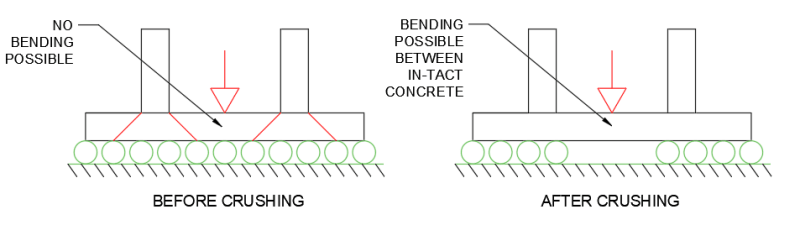

Question not for a current design, just interested.
I'm going through AISC DG1 - Base Plate and Anchor Design and noticed that the guide recommends designing the base plate for bending when a compression load is applied to the column. How in the world would a base plate bend from an axial compressive force if it is continuously supported by the concrete underneath it? Is this to account for voids in the concrete? I get that the DG treats the bearing force as uniform across the bottom of the base plate and this force profile would cause "upwards" bending of the base plate if it were able to "travel", but the concrete cannot act on the base plate through a distance.

Is the below inaccurate? I do somewhat understand that the plate would have the tendency to bend, which is reacted by the concrete more at mid-span, but it's still not quite clicking in my mind strongly

You are assuming concrete/grout is infinitely rigid which is not the case. While the concrete is significantly rigid it still experiences small strains from the bearing pressure, and once you have any movement at all then you develop curvature in the bearing plate. The rigid plate assumption while in theory not correct has been proven to be safe, in reality the pressure distribution will be more localized around the column profile.
aha now that makes sense! I made this much more complicated than it is. I can say I learned something today now. Thanks Celt83

Intuitively, it seems as if the forces in the concrete pier would be highly concentrated under the column web and flanges. The column would act as a "stamp". This presupposes that the concrete is very stiff.
If the concrete pier were "soft", the base plate would uniformly distribute the forces to the pier under the entire plate. This is how we model it (conservative for the base plate design) but it doesn't seem to be intuitively correct. How many base plates have failed in bending in a gravity column? How many piers have failed by the concrete sintering or crushing right under the column flanges? None?
The truth lies somewhere in the middle, I presume. The pier stress under the column flanges is likely much higher than estimated using the uniform-distribution-under-the-base-plate model and the plate stresses are much lower than we calculate. The pier is OK even though it might be stressed (locally) well in excess of f'c.
Structural engineers feel good about their super-thick base plates because they are following AISC's design methodology and thick base plates look serious (i.e. cool).
At the end, don't forget this is a conservative practice to ensure the plate have adequate strength to resist incidental bending, as there is no such prefect column exists.

These are all good points. Intuitively I wouldn’t imagine a base plate would ever fail in compression bending if constructed correctly, even if grout (or concrete) crushed near the center of the base plate it would be confined by the remaining grout and offer some bearing resistance.
