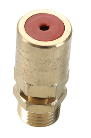

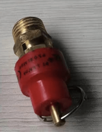

Apologies in advance if this topic does not belong here.
I have a question about a a pressure release valve type being used on a product.
Note
max pressure: 135 PSI.
Drainage cock is control type not ON/ OFF: image B:2
It is being supplied with a pressure relief valve (without manual release): image A
Questions
1) Should this product use an auto pressure release valve with manual release pull: image B:2 ?
It seems to make sense from a safety point of view in that you can:
- Check normal functioning of auto pressure release before use, by engaging the valve spring to make sure the spring moves freely (e.g. ball is not stuck to seat)
- When draining tank of condensation: Can first release the tank pressure by engaging the valve spring before opening the drainage cock
<or>
Is the risk low enough that the user can simply partially release the drainage cock (control type valve) to let the pressure out, before opening it all the way (drainage cock is also the pressure release) ?
2) Does anyone know if (image A) comes in "manual release type" with chrome steel seat material ?
The explanation I was given behind the use of (image A) was:
image A: is steel, comply to EN
image B:2: is alloy, not comply to EN
IMAGE A:
IMAGE B:
Appreciate any thoughts

Most of these small compressors have a relief valve with a ring. The ring allows one to periodically test the relief valve.
For small compressors like you have shown, it is common to relieve the pressure with either the drain valve or the relief valve. For large compressors, this would be inappropriate and unsafe.

I've read this a few times now and am unsure which valve is which and what the difference is.
But neither of those valves should be used to used to depressurise the receiver. That's not their job and you risk damaging them by either using them as control valves to control air releases or just sheer high velocities. Use the main outlet and a hose and proper valve to de pressurise the receiver.
Image A looks like Brass to me.
As Bimr says, read the manual, but I would certainly greatly reduce air pressure before draining water off as it will come out very quickly otherwise and will tend to leave a lot of water in as the air cones down through the water layer.

the product I am receiving is shipped with this type of automatic (8 bar) pressure release valve:
After doing some research, seems all products in this range have an auto pressure release valve with manual release ring:
The supplier said they did not provide the valve with manual release ring because it did not conform to an EN standard.
Now I wonder why the manufacturer did not provide a release valve with ring that complies with the EN standard. -- Surely there must be one that complies [ponder]
My initial feeling was that not having a manual release would violate safety protocols because:
1) cannot periodically test auto pressure release by pulling the ring
2) cannot release the pressure before opening the tank drainage cock to release any condensation.
> Manual says to just to open the drainage cock, no depressurisation protocol given.
> From what I gather here, the operating pressure is low enough that opening the drainage cock without first releasing the pressure is not high risk.
- The drainage cock is a control valve type so it can be opened gradually.
- I shall inform anyone operating product about necessary precautions before opening the cock to drain (a potentially pressurised) condensation tank.

Here are some portions from the operating manual from another brand with safety warnings. Also a youtube video demonstrating how one person tests the safety relief valve:
Drain air tank daily or after each use.
TO CHECK SAFETY VALVE
Risk of Bursting. If the safety valve does not work properly, over-pressurization may occur, causing air tank rupture or an explosion. Risk from Flying Objects. Always wear certified safety equipment: ANSI Z87.1 eye protection (CAN/CSA Z94.3) with side shields1. Before starting compressor, pull the ring on the safety valve to make sure that the safety valve operates freely. If the valve is stuck or does not operate smoothly, it must be replaced with the same type of valve.
Link
