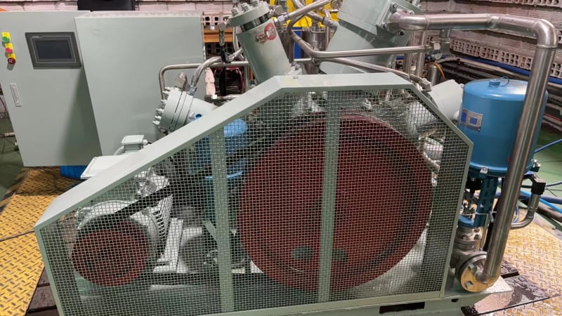

We need to mount an identical pair of 11 kW shaft power oil-free reciprocating gas compressors inside a 20ft shipping container.
The manufacturer recommends a typical ACI-351 type 0.6 m thick steel reinforced concrete foundation weighing 5 times the skid weight. No specific information was provided for container mounting the units. No imbalance / vibration information is available.
My question is whether it is acceptable to mount both compressors on a single, reinforced concrete "foundation" that is anchored to the container floor (large lag screws cast into the concrete attach the foundation to the container).
Is epoxy grouting required for small machines like these? I'm considering Chockfast grey for both anchor bolts and the baseplate (2 separate pours).
Is all this effort required or am I completely over-complicating this install because small compressors don't require this level of foundation engineering?
Your feedback is much appreciated!
- Felix
Here is a more detailed description of the compressors, also a picture is attached showing one of the units.
The compressors each have four stages (arranged in a dual 90° V-twin configuration) and are driven by a 15 kW 4 pole motor. Belts and a flywheel drive the compressor input shaft at 450 RPM. The motor is VFD driven, skid weight is 950 kg.
CO2 is compressed from atmosphere to 160 bar at a flow rate of 35 Nm^3/hr. Only one compressor will operate at a time (100% standby).

5x mass method is normally good up to 250 HP.
Epoxy grout not required.
Why 2 pours?

Two pours, first to epoxy the anchor bolts into the foundation holes, the second to grout the machine baseplate to the foundation. I've read that anchor bolt nuts should be hand tight to prevent movement of the equipment during grouting, hence the need for two pours.
Would you recommend cementicious grout or no grout at all for a small compressor like this?
No grout is probably fine. Use cement grout, if you do.
OK. I wasn't thinking of grouting as a pour.
All this work for a foundation and you're going to be bolting it to a 1/2" plywood floor that can have a fair amount of flex? Are you putting spacer blocks underneath to support the compressor foundation to the pad the container sits on, or are you keeping the exterior unmodified to retain its seaworthiness?

The container exterior can't be modified because, as you correctly pointed out, it needs to maintain seaworthiness.
The concrete will serve as a "Inertia block" type of foundation for the compressors.
I'm debating whehter to use lag screws to attach the foundation to the container plywood, or if the concrete should be poured on a vibration isolation pad like this one:

We've been doing 20ft container pump rooms for a little bit now, each one is a new learning experience. We're doing domestic shipping, so we've been cutting in doors and access hatches and things. We went down the road of shimming the underside to make the floor more stationary and to do a better job of distributing the load on the final concrete pad, it's not something I would recommend as the undersides are heavily coated in whatever they're using for corrosion protection, which we've also seen variations of.
Be aware the floor type and thickness can vary. We've seen 1/2" and 3/4" plywood floors. The entire floor is floated as the container only contacts the ground at the corners, we've seen some containers that will become fairly springy when loaded with equipment, and we've had to add center posts and other means to deal with the container bounce or flexing when picked up as it has a tendency to tear out anything hard piped (probably not an issue if you're not tied into the walls).
