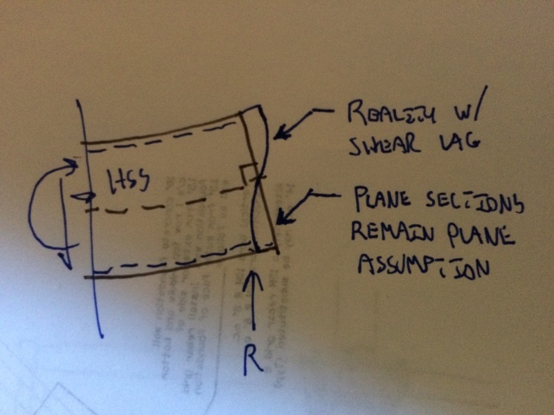

In reality, I would expect a tight friction fit to change stresses a bit. Intentionally, I've just been discussing flexural behavior assuming that plane section remain plane. In the wild, the strains at the extreme ends of the two tubes would probably differ a bit due to shear lag up the sides of the tubes. That difference would be, at least partially, ironed out by the action of the friction generated at the interface.
What do you mean by "assuming that plane section remains plane". Are you referring to the cross section relative to the NA? Why would it be out-of-plane? Also, where does shear lag come into play? At the released ends of the tubes?
This is now beyond the scope of my analysis, but it is good to know/understand nonetheless.[/tt]
Yeah, it's beyond the scope of all of us that spend our time out in profit-land trying to earn a living. See if the sketch below helpes at all. It applies at all points along the length of a member with the effect being most pronounced at the locations where shear is at its peak values. The effect is usually so minor as to be of no practical consequence.
