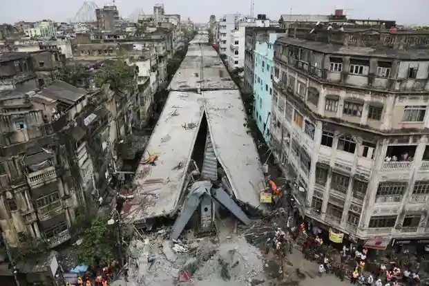

Hey
please see two attached photos of a concrete bridge being built next to exiting residential building.
( I don't want to mention the country but the wind speed is around 80 mph)
since I am not expert in bridges design I need some answers to the following with some references please:
1-what is the max clearance from the bridge side to the building ?
2-the bridge foundation is isolated footing on piles and the footing of the existing building is raft foundation ( both of them on caly soil) will the weight of the bridge affect the foundation of existing buildings?
3-the spacing from the bridge to the building now is very small, do you think the bridge will have a side sway some how and it will lean on the building and affect its structural integrity?
4-i am assuming accidents may happen, will be any impact load can be applied on the existing
building ?
you can raise any other concerns if you want !
Ok... I've never seen something like that. Talk about building on the edge...
The country matters a lot since it will state which code applies to your region. I'll post some general answers below; however, it's important to remember that some (or all) of these things may or may not apply in your region. Without calculations, its also difficult to say how significant some of these effects might be. Anyways, in order:
I'm more worried about the opposite. The building may be pushed towards the bridge by the wind, closing the gap. I wouldn't expect any significant sidesway of the bridge due to wind, since the buildings block the wind on both sides. Note that this assumes there are no seismic effects to consider in your area. If seismic is a concern, the gap between structures should be able to accommodate the expected seismic deflection (in other words, gap > [expected bridge deflection] + [expected building deflection]).

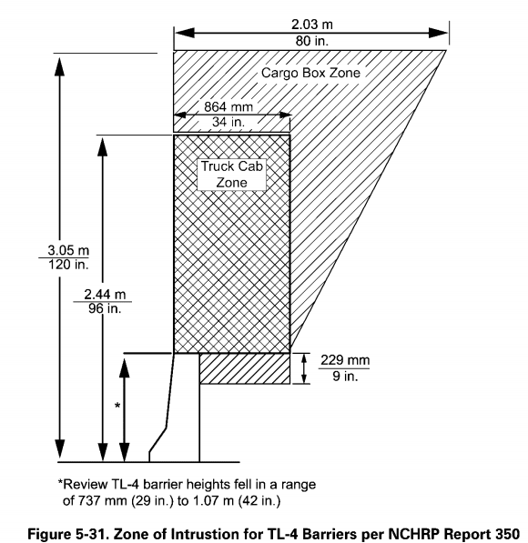

Impact loading should get applied on the (rigid) bridge barrier, which should prevent vehicles from hitting the building. That being said, I would definitely want a TALL barrier. If a truck impacts the barrier, the top of the truck may tilt into the building, which would be, well, bad. See the following image, which shows how much a truck may tilt past the barrier (assuming a TL-4 barrier, image from the AASHTO Roadside Design Guide)

I'd double check the local fire code. Those windows and balconies probably don't have fire-rated windows. I'm not sure if this situation is specifically covered by the fire code (a street on the 5th floor with 0 clearance?), but it's definitely a concern.
Seismic may or may not be a big concern in your area. Bridges usually follow a strong beam-weak column design, which means that the bridge will sway a lot under an earthquake (and will most likely hit the building).
If you have truck traffic in the bridge, the barrier should be tall enough to prevent the truck from tilting into the building.

1-what is the max clearance from the bridge side to the building ? There are no set minimum clearance requirements that are set forth by Bridge Design codes that I use. The most prudent thing to do would be to run a response spectrum analysis on the two different structures and check their lateral displacement. Assume there is a chance that they will both be at their max displacement while out of phase from one another and use that clearance as a bare minimum, but geeze, I would think that is a theoretical number and that you would still want some extra buffer beyond that. That sucks for the people that have to live in those buildings.
2-the bridge foundation is isolated footing on piles and the footing of the existing building is raft foundation ( both of them on caly soil) will the weight of the bridge affect the foundation of existing buildings? As mchen96 noted, the bridge should have little to no effect on the building but the building has a real probability of having an effect on the bridge. Even if they are end bearing piles, the raft foundation could impose a lateral force onto the piles during a seismic event.
3-the spacing from the bridge to the building now is very small, do you think the bridge will have a side sway some how and it will lean on the building and affect its structural integrity? I think that if pounding is a possibility due to an undersized separation between the structures then yes, you could potentially have one or both of the structures damaged.
4-i am assuming accidents may happen, will be any impact load can be applied on the existing Standard impact railing in the US is anywhere between 18" to 56" depending on design use, Average daily traffic, and vehicle design speed. The railing would deflect and the truck itself wraps over the top of the barrier in an impact so if it is really close then yes, it could be a hazard. I would hope they designed a very tall barrier with a sound barrier on top of that.

Figure 5-31 posted by mchen96 looks like the best bet for an explicit code requirement that elevated roadways should not be built that close to residential building structures.
