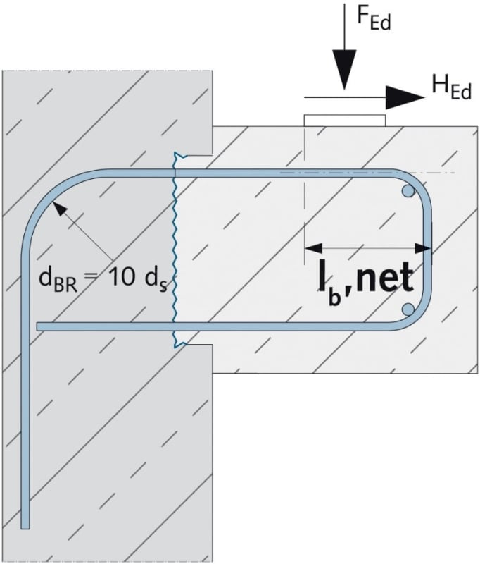

If you want to prefer secondary pour , there are two options;
1- rebar cage is bended and placed with polystyrene board to make pocket, then the rebar re bended and the cage is completed then the second pour.

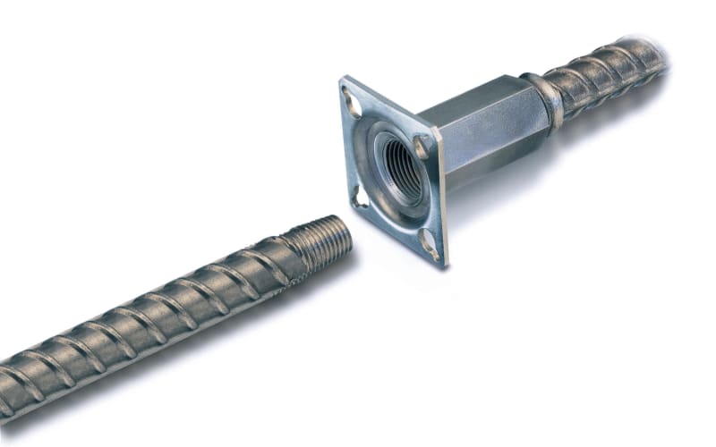

2- You may use threaded rebar coupler.. The coupler will be fixed to the interior surface of the formwork together with first embedded rebar and then second bar is installed after formwork removal.. The coupler will be similar to the following:

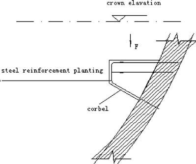

..and with chance i found the corbel sketch at the web;
Another example for the second phase corbell;
