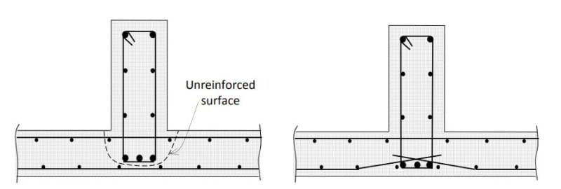

The Situation
- Solid precast plank as shown below. Heavy transfer slab loads.
- Normally a one way spanning thing but, at the supports, the thing has to span laterally over some louver openings that extend to the underside of the slab.
- Local gaggle of rebar placed in the ends of the plank to serve as lateral beams of sorts (tiny spans).
The Question
Good detailing practice, as I know it, would have the bottom bars of the supported slab run up over the bottom bars of the supporting "beam". That, so that there is no potential crack such as the one shown in green that does not intercept any reinforcing. I might accomplish such a thing in several ways:
1) Drape the slab rebar.
2) Lap the rebar with an offset piece that comes up and over the beam bottom bars, a bit like a 1:6 column rebar transition.
3) Simply adjust the layering and take the hit with respect to slab flexural depth and crack control.
I could do these thing but the question is this: do I need to? All of the proposals above would be a bit annoying to my precast client for various reasons.
Some Related Logic
4) For a more discrete, serious beam & girder situation, I would definitely do this.
5) In a way, a similar condition exists everywhere within a two way slab and we do not do this.
6) So is this closer to a serious beam situation or closer to a two way slab situation? My gut feel is that it is the latter and I'm inclined to not worry about this here.
Note that, for the purpose of this question, one needs to really consider the last sketch above without the bearing reaction as that reaction is not there when the beam is doing it's thing.

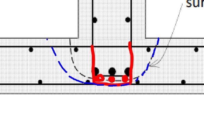

It's really something like this that I'm thinking of.
This particular example is a bit unique given that, unlike with CIP, very little negative moment will be developed in the slab at the support.
Thanks all for the input.
dik said:
With the small bar size, I suspect that your proposed cracking mechanism will not occur.
It's kind of a weird thing in that:
a) Yeah, it's good detailing practice.
b) There's really no "check" to be done when you violate it per se.
The small 10m stirrups would be to avoid the cranked bottom mat. I was thinking it would only exist on the inside of the group of bars so it would cross your potential crack. Probably only need 2 or 3 per louvre opening. Alternately, don't crank the bars, or lap them, just drape them a bit at each end. It's not like at the ends of the slabs they're significantly participating anyway, I'm sure by the time you need the full effective depth, you'd have it.
I would view the stirrup solution as being effectively this. As such, I'd consider it more or less the same problem to the extent that there is one. A crack just at the stirrup level isn't so much different from a crack below the stirrup level.
Do you think that, perhaps, there's really no logic in this concept at all in the absence of stirrups? Sure, you've got slab bottom bars hanging over beam bottom bars but, without some kind of vertical stirrup leg, is there a point to that? We don't ostensibly design RC concrete to have things hanging from rebar but that concept informs a fair bit of detailing practice nonetheless.
Something just sort of rubbed the the wrong way when I sketched out the supported member bottom steel running under the supporting member bottom steel. Habit more than anything I suppose.
I'm thinking the stirrup solution goes from your slab bar to your slab bar, not beam bar to beam bar. So it should prevent the failure you're anticipating or you've got bigger problems.
