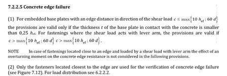

I am working on an anchorage design in accordance with Eurocode. In cases where Eurocode is unclear, I can refer to other sources, and in extreme cases I can apply for a waiver of a code requirement if I have a good justification to do it an alternate way. So, here is the situation at issue:

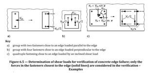

The relevant Eurocode clauses for concrete edge failure:
From 6.2.2.2:
I think its pretty clear Eurocode requires me to check this edge failure area against the full shear force:

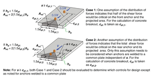

Now if I look at ACI, this situation would warrant the following 2 cases to be checked:
Clearly, the Eurocode check is much more conservative, and in this case is causing serious problems.

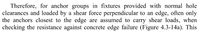

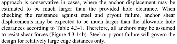

Now, I'm also referring to a very helpful reference book: Anchorage in Concrete Construction, First edition (R. Eligehausen, R. Mallee, J. F. Silva). I don't know the history exactly, but it seems that a lot of the research and explanations adopted in this document are incorporated in both Eurocode 1992-4 and ACI 318. (In general, ACI seems to more explicitly state some of the explanations and reasoning from this reference in the commentary column).
I'm sharing a couple of pages attached in case anyone is interested in some more reading, but essentially the book agrees with the ACI reference manual. This figure below is particularly illustrative, and this part of the text was persuasive to me: "If the shear load is initially resisted by the near-edge anchor alone, it will generate a concrete breakout crack. Following displacement sufficient to bring the rear anchor into a bearing condition, that anchor will then resist the entire shear load.
Now, the question I have for all of you is if you can think of a persuasive argument why the Eurocode assumption on shear distribution should be adopted over the ACI/reference manual assumption, other than "just cause" it's more conservative.

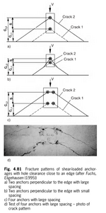

The preliminary design assumption was that supplementary reinforcement can be provided along the entire length of the anchor. Eurocode is silent about spacing of the supplementary bars in the vertical dimension, only giving requirements for the bar size and the horizontal clearance between bar and anchor to be as minimal as possible. So from a purely code compliance standpoint, this designseems acceptable.
But, then I turn to ACI and the same reference text I mentioned above. Per the reference text: "If the hairpin is positioned away from the surface of the concrete, larger deformations of the stud are required to activate the hairpin. According to the limited experimental investigations of Ramm, Greiner (1991) the failure load associated with this geometry decreases as much as 30%, depending on the edge distance, if the hairpin is positioned at a depth of 50 mm rather than with normal concrete cover."
And per ACI R17.5.2.1:
This makes it clear that really only the uppermost bar, maybe 2 or 3 bars at most should be counted. The figure from ACI makes clear why - bars lower than that are not sufficient anchored into the failure plane to provide much help. In fact, in my specific scenario with hef >> cover, many of these supplementary bars won't cross the failure plane at all.
Now again, the total shear force is high, so when converted into tension in the supplementary reinforcement the original design called for 12 layers of supplementary bars (24 legs total) along the length of the anchors. Given the size restriction on these stirrups, there's just no way to make it work only considering the top layer. Same issue if we try to count on supplementary surface reinforcement rather than stirrups.
Putting aside code compliance issues, do you all agree with my interpretation of ACI (and the reference text) that only the uppermost bar(s) should be counted? And do you agree with this requirement, or see any reason why it would have been omitted from Eurocode?

Yes, the Eurocode in that clause is implying that you can share the load to all anchors. Look up fib Bulletin 58 if you are after resource showing how to design for multiple anchors to be effective. The method is generally referred to in the literature and standards as shear resisted by the back anchors, which can be achieved as noted above by others when you eliminate the annular gap between anchor and baseplate such that you can ensure all anchors are effective in resisting shear. The fib guide has an in depth discussion. There are drawbacks to the method - the guide limits its applicability to (from memory, double check this) 3 rows of anchors perpendicular to direction of shear. Another consideration is that if your crack propagates from the back anchors then theoretically all the anchors below that will be ineffective at ultimate limit state as they are embedded in the dislocated piece of concrete, so all your shear (in terms of steel shear capacity of the anchors) will be put through the back anchors only. Pryout is calculated similarly based on a reduced tension cone area.
In terms of supplementary reinforcement if you use the simplified strut and tie method described in the Eurocode you don't have the 0.5 reduction factor that they introduce to allow for the gap between hairpins and anchors which will get you more capacity. To me it looks like filling the holes plus supplementary reo looks like the way to go. Regardless of the code restrictions spreading your shear over a wider area by having the filled holes will enable you to engage more supplementary reo. Don't forget to account for the shear eccentricity in determining the tension in your supplementary reo, there are formulas for this in the Eurocode.
In terms of shear distribution for your plate you will not usually get uniform shear distribution (the V/15). If you have a cleat or something introducing the load the middle columns are always more highly loaded. I'd even suggest investigating whether you need the bottom row of anchors - 15 is quite a lot. You could test the connection without them in order to bring the shear further from the edge.
