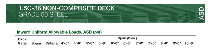

Has anyone dealt with a situation where concrete form deck (non-composite) was ordered too short and one of the ends won't be able to bear on a support? Beams are 7 ft OC, but 13 ft form deck was ordered. I can provide a sketch in the morning when I'm back at my desk.
Would it ever be acceptable to arrange the form deck in a way that the end of one deck laps the end of the next deck between supports (in mid-air)? The lap joint would need to be connected together. I've crunched some deck bending stress numbers already but wanted to see if anyone has even come across something like this before... (P.S. Slab is designed to be self-supporting. Form deck is for construction only. Area is constantly wet, so I expect the decking to rot away over time.)

Beams are W8x18 (5.25" flange). Form deck is 1.5C-36 (20 gage) Gr. 50. Slab total thickness is 5"-6" (low point in the middle for drainage). Slab is roughly 11.5 ft x 42 ft.
That's pretty small area. I'd be inclined to just have the contractor shor the laps where they land as I mentioned above. I guess you'll need some way to attach the deck to the slab at the joints to keep it from dropping at the laps in service.
You could also construct some temporary wood thing between the beams to support the floating lap joints. Just inspect it yourself prior to por if things are moving fast.
I think something like that would be doable. I was able to forward my crude gallery elevation sketch to my laptop. Attached
I was thinking this arrangement could potentially work. The middle form deck would overhang on both ends, and the two outer decks would overhang on only one end and be supported by the middle deck.
The middle deck is overstressed when I place an equivalent point load at the end of each cantilever to mimic a reaction from the two outer deck loads. That's assuming there's no connection at the lap joint and the other decks are just dumping load to the middle one. Perhaps if I join the lap joints sufficiently, the decking could go back to behaving like a continuous piece.

Here are the rough calcs I did last night. After some sleep, I realized I doubled up on the applied load / overhang length. The two deck pieces will lap 2 ft, so my point load on the middle deck should act closer to 1 ft away from the support vs. 3 ft. That will help. I only checked dead load last night...still need to add construction live load and sharpen my pencil. Contractor is planning to stich the laps together and slam some angles below to provide some additional edge support. One of the iron workers I talked to was on a bridge job that had several mid-air deck laps, and they just used metal deck screws at those joints without issue.

KootK, thanks for the help and kind words. To put this to rest, attached are my updated calcs with a more accurate 1 ft overhang instead of 3 ft for the middle deck, which is no longer overstressed. The outer decks are slightly overstressed in positive bending with 75 psf DL + 40 psf LL, but I'm not too concerned. DL is technically a little lighter since it's not a true 6" slab.

RattlinBog - You are wading into design of "means & methods" of concrete forming which is very different from design of permanent structures. From that viewpoint there are wildly over optimistic assumptions and glaring omissions in the calcs. Stop before this project ends with a pile of crumpled steel, wet concrete, and injured (or worse) workers. In 20 years on Eng-Tips I've never said something this dramatic... but I will today. Nitty-gritty details if you want to go there, but to start:
How do your calcs justify that loading of 115 psf (75 psf + 40 psf) on "butchered" deck is acceptance when Vulcraft rates intact deck at 93 psf (simple span) or 91 psf (two-span continuous)?

4. For metal form deck, I originally required non-composite 1.5C-36 (18 gage) Gr. 50, assuming two-span condition. (I looked through the same Vulcraft tables you included above and also used Vulcraft's unshored construction span deck design aid.) Looking back through my notes, I used DL=66 psf (accounting for avg thickness with 1.5" deck) and construction LL=20 psf. I forgot about the smaller value in my more recent calcs. I tried to be a bit conservative since I haven't encountered an overhanging deck condition before.
5. Contractor was selected, and contractor ordered materials. Neither of us worked with a separate party to complete a detailed design of the form deck. I assumed contractor would order what I called out, and I assumed form deck sheets would come in 14+ ft lengths.

9. Same Tuesday evening - I did some reading from literature before diving into calcs (SDI Manual of Construction with Steel Deck 2nd Ed; SDI NC-2017). The SDI Manual of Construction has one example on pg. 38 (see attachment) on penetrations that is somewhat similar to my case. They're just checking fb = M/S.
10. Using the section properties for the 20 ga. deck (unsure of what actually came on site), I went through the calcs that I attached in my earlier reply. I used DL = 75 psf and LL = 40 psf, which I believe may both be a bit conservative.

This reply is already too long, but I'll gladly answer other questions. SRE, you are correct about 75 psf DL + 40 psf LL exceeding the allowable for 20 gage deck in Vulcraft's span tables. Like I mentioned above, I originally selected the deck size (18 gage) in May based on 65 psf DL (5.25 avg slab thickness) + 20 psf construction LL, but in my haste this Tuesday evening, I had forgotten that and used 40 psf LL instead. The calculations I did on Tuesday took into account actual vs. allowable bending stresses (f = M/S). I did not consider the Vulcraft span tables because I figured they were no longer applicable given my unique situation. I've been working 12-14 hours days this week to try to stay on top of issues as they come up and keep the workers safe. I have no interest in cutting corners or doing something unsafe. The parties involved on this project are myself (owner and designer), the contractor, and a certified inspection firm. Who else should I turn to? I haven't reached out directly to Vulcraft, but perhaps I should.

A heads up for now: Look at deflections, you have not done this. Deflection almost always controls on form work for an elevated slab. If deflection is ignored, control of slab thickness is lost, meaning load increases, which can cascade to structural failure.

The problem you have is NOT your calculations (100 psf total load should be good for this project...reasons later) The assumptions being used are flawed. Designing "means & methods" is different, as I mentioned before:
1) Deflection controls, for the reason stated.
2) Use available material (either on hand, or readily available... you are already dealing with that).
3) Magnitude and Location of loads (like fresh concrete during placement) during construction cannot be accurately predicted. To compensate, form work has to be over designed (from the viewpoint of most permanent structure engineers). In your calcs, concrete dead load is "ideal"...assumed to be uniform and all-at-once in place. No unbalance loading, no provisions for point loads from workers walking on the forming deck or chairs supporting rebar mat.
I doubt 13" long, 1.5C-36, Grade 50, 20 Gauge can be made to work safely (Your 18 Gauge two-span appears to be perfect for this application). Even if cut to use as 7' simple span, deflection will be ridiculous... 100 psf >> 41 psf that Vulcraft gives for L/240 deflection.
If you lap the sheets per your calcs, deflection will ruin the neat point load assumption of the "long" cantilever bearing on the "short" cantilever. Your first set of calcs, allowing for the double loading error you caught, is probably closer to being accurate... and those calc's results are screaming "Failure", if I remember right.

I'm tracking with what you're saying and agree. Trying to keep my responses shorter for the sake of time. I'm going through some deflection calcs now (and of course I have 10 other projects screaming at me). As you've probably already figured out...the decking is installed and concrete pour is tomorrow... I may or may not have lost some sleep this week.
This is what I can say has happened in real life (right or wrong; just telling the truth): the decking has been installed as sketched. I believe it is 18 gage. At these mid-air laps, contractor installed deck screws at every single rib (I believe 6" OC). They also installed the L4x4x3/8 angle I mentioned earlier below the lap to try to take up some deflection. That's what we had on site to work with. I'm planning to run through a bending strength and deflection on the angle to see if it's doing anything. I hate single angle bending, but I'll go through it.
