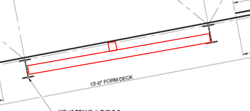

I feel a bit ridiculous asking this, but I could use a sanity check.
Has anyone dealt with a situation where concrete form deck (non-composite) was ordered too short and one of the ends won't be able to bear on a support? Beams are 7 ft OC, but 13 ft form deck was ordered. I can provide a sketch in the morning when I'm back at my desk.
Would it ever be acceptable to arrange the form deck in a way that the end of one deck laps the end of the next deck between supports (in mid-air)? The lap joint would need to be connected together. I've crunched some deck bending stress numbers already but wanted to see if anyone has even come across something like this before... (P.S. Slab is designed to be self-supporting. Form deck is for construction only. Area is constantly wet, so I expect the decking to rot away over time.)

phamENG - Yes, more supports could help convert "single span with cantilever" deck to multi-span.
Vulcraft shows three-span continuous with allowable load of 113 psf and max deflection load of 71 psf. Still a problem but much better. Before electronic calculators, three-span continuous was often considered as good a performance from a given beam as routinely practical.

L4x4x3/8 angle at the laps was field welded to WT8x13 truss bottom chords and is tight to form deck. It's still not exactly ideal.
For the mid-air lap splice deck screw connections--understood about calculating available shear strength. I'm wondering about what are the actual demands that those screws would see. Sorry, my brain is fried right now after a lot of late nights. This isn't exactly a "moment" connection. Or can I assume it is and design for C=T= M/d?
Deflections calcs attached. Also modeled L4x4x3/8 angles taking load with the W8x18 beams in Risa-3D. I just don't have time to go through the single-angle flexural checks in AISC by hand right now... Given 75 psf DL + 20 psf LL, the L4x4x3/8 angle is at 1.7 utilization and L/y = 89 (1.4" max deflection). Assumed angle has a tributary width of about 3.5 ft and an unbraced length of 10.5 ft (obviously not great). I could have them puddle weld deck to angle from above to reduce unbraced length.

This might have been mentioned, so sorry if I am beating a dead horse.. I see you are putting calculations in with a cantilever/overhang; the deck will see a substantially higher downward reaction with a cantilevered end than is normally anticipated. Have you considered web crippling of the deck over the first support, with all of the concrete weight on the deck plus workers stepping over the deck webs?
This is what I was hoping would be possible for deck shoring.

You could also construct some temporary wood thing between the beams to support the floating lap joints.
It's a trip to Lowes and a few thousand $$$ but taking your spans down from 7' to 3.5' would do rather a lot for deflection. That seems like a reasonable cost if it buys safety for your guys and peace of mind for you.
This stuff would still have to be erected safely but that can probably be dealt with somehow with appropriate harnessing or whatever.

KootK, sorry, I must've misunderstood what you meant the first time you wrote that. Seems obvious now looking at the sketch. I was thinking of some timber beam spanning from truss bottom chord to chord (not connecting to the W8 beams perpendicular to the trusses). We have those steel L4x4 angles spanning from chord to chord below the laps. I believe they'll add some stiffness at the lap but unclear how much.

For the overlapped decking, I would assume that as a UDL, the 3' cantilever supports about half the load that is applied to the 6' cantilever. I'll see if I an make a sketch of this.

Caternary action with the lap fasters transferring deck tension in shear?

Still trying to figure our if the 6" OC deck screws at the mid-air lap are doing anything and how to go about putting a value to that. Would I just check shear demand per ft?
Determine the shear by assuming and calculating tension from caternary action, as KootK stated and I described.

I must not be looking at the catenary action tension quite right. Attached.
Cable tension approaches infinity as cable sag approaches 0, right? If I treat this form deck as a cable subjected to a uniformly distributed load, that means it will see a larger tension force with a smaller deflection (sag).
In my attached calcs, 90 plf (per ft of width) on a 7 ft span with 0.5" deflection yields 13.2 kip/ft. For 1" deflection --> T = 6.6 kip/ft; 0.25" deflection --> T = 26.5 kip/ft. For the 0.5" sag, I would need screws every 0.3 inches...
For fun, I checked the tensile strength of 20 gage form deck. It has an area of 0.758 in^2 per foot. (Fy*Ag)/1.67 = 22.7 kip/ft allowable tensile strength. Using the sagging cable analogy, the form deck would rip apart at 0.2" of deflection.
