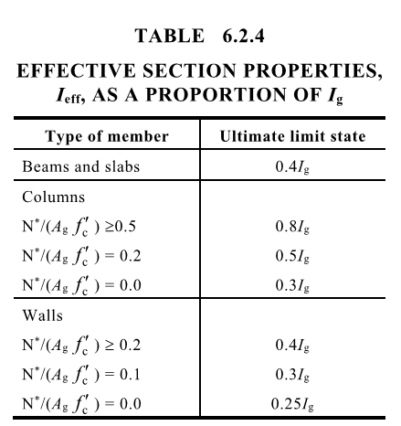

Here are the Australian stiffness modifiers for cracked sections, for comparison. When columns don't have heavy compression, the stiffness becomes similar to a beam because the column is functionally similar to a beam in that case.

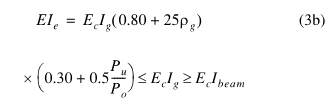

Turns out the source articles for that ACI equation are available online:
Theory - Experiments -
Note that there's an error in Equation 6 of the theory paper. It's supposed to be "...+0.5*Pu/Po" (instead of subtraction). It's correct in the experimental article, where it's called equation 3b (image below). Looks like the Australian code is similar to this simplification, which is only accurate at the ultimate limit state, ie when you're sitting on the interaction curve, not inside the curve.
The theory paper has tables that show how the equations vary with the inputs over fairly typical ranges, but the maximum eccentricity considered is 0.8*section depth. Sway frames may go outside that.

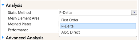

If the software uses the geometric stiffness method, there is no separate "P-Big Delta" and "P-little delta"; the full p-delta is captured automatically along a member, with greater accuracy as element length is reduced. On the other hand, some software use equivalent nodal shear, and in that case, "subdivision" of some kind might be needed.
centondollar -
There are multiple ways to incorporate P-Delta.
1) Using secondary shears: This only applies at joint locations. I know that RISA-3D used to work this way. I'm not sure of any other programs that do that.
2) Geometric stiffness adjustment: This method does NOT guarantee that this will account for both types of P-Delta.
a) This can be done to only account for joint translation in which case, it is (like method 1) only accounting for P-Big Delta, and would still require sub-division.
b) If the geometric stiffness adjustment accounts for BOTH nodal translation and nodal rotation, then yes it will account for both Big Delta and little delta effects. However, I would suggest that even if the software claims to do this, that you would be wise to test it out first. Specifically comparing it to the "benchmark" examples in the AISC commentary.
