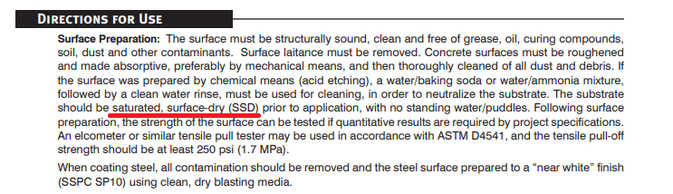

Strctpono said:
I am not too familiar with Megapoxy but I typically use products made by Sika, Mapei, or Euclid. All those epoxy bonding agents still require that the concrete be SSD.
I thought epoxy primers can go on dry concrete?, as it’s two part epoxy resin, not a cementitious system.
I can't speak for all epoxy primers, but the ones I use are all based on the same premise. Three component, water based epoxy, with cementitious material added. See snipet from Euclid's Duralprep AC data sheet. It's the same for Sika and Mapei's products. They are good products and if applied properly get bond values of >2500 psi.
As jayrod and JAE have said, it is very easy to incorrectly apply the bonding agent. They have multiple mixing components and typically have short open window times so yes, it can be a bond breaker if the Contractor doesn't know what they are doing. I don't specify them unless I need them and/or trust that the Contractor knows what they are doing.
For your application, roughen and SSD should be sufficient.
