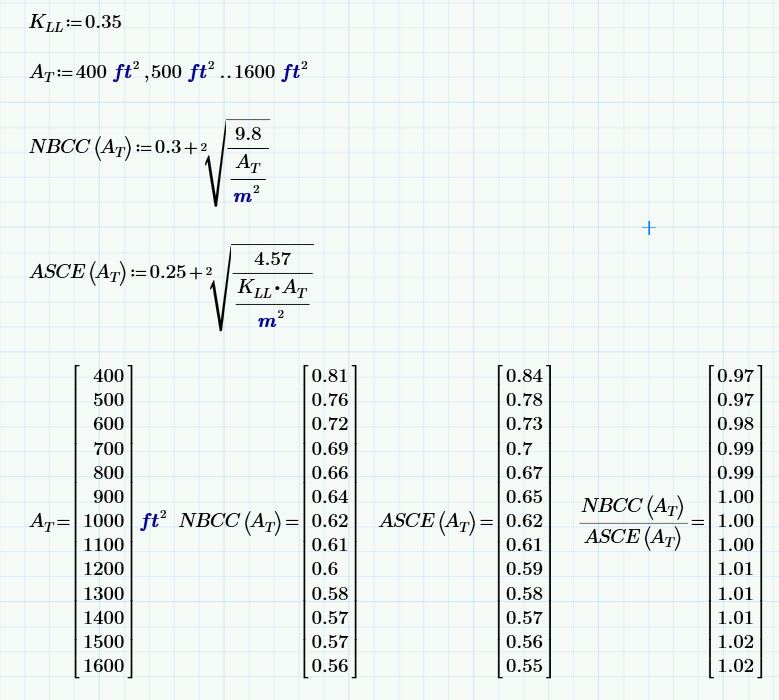

It is similar in many respects but not the one being debated here. NBCC live load reduction IS indexed to tributary area rather than influence area which, admittedly, does make it a fair bit easier to apply. For kicks, I set up a comparison of the methods, shown below. The Canadian method seems to be much more conservative and would effectively align with the US method for KLL = 0.35. I've frankly forgotten what I'd intended to prove with this but, since it's already a bird in the bush, I figure that it wouldn't hurt to share. Maybe it's flawed and someone can tell me how. I probably coulda just some to the same conclusion via algebra.
At KLL = 1.0, NBCC/ASCE ~1.32
At KLL = 2.0, NBCC/ASCE ~1.53
At KLL = 4.0, NBCC/ASCE ~1.70
The scatter is greater at higher KLL values.
