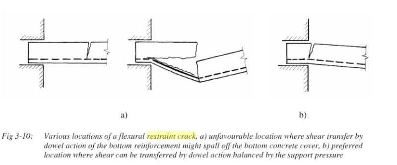

Similar to the subject here thread507-463800, I have been concerned in the past about the shear capacity being compromised due to a lack of flexural reinforcing and excessive cracking. I don't see anything in ACI that addresses it. So, for example if there is no top slab reinforcing in the thread above, would that affect the shear capacity of the slab assuming a crack propagates a distance away from the support?
Yes, shear models rely on flexural reinforcement to complete the truss anology. No flexural reinforcement in a high shear region is a issue
Most codes have allowances for minimum shrinkage and temperature reinforcing to ensure the concrete behaves as expected such that the rules in the code can be applied.

It depends on the intensity of the load, without flexural reinforcement, a beam can still function, albeit allows very limited load. See ACI 318 section for "structural plain concrete" for more information.
haynewp - I guess I've always thought that if there was adequate flexural reinforcement on the bottom, extending into the support as required by ACI, then the shear of the section based on ΦVc would be determined and compared with Vu a distance "d" from the support....for slabs.
For beams it would be ΦVc/2 and for joists it would be ΦVc/2 x 1.1.
If Vu was over ΦVc/2 for beams, I'd have to put in minimum stirrups of course.
For the slab condition you referenced, if the slab cracked over the support then assuming proper bottom slab reinforcement I'd be OK with the slab shear capacity assuming a nice straight saw cut over the beam to ensure the cracking didn't wander out past the edge of the support. If it did, then that section where the cracking got out past the support would indeed give me worry.

1) I've shared a similar concern for a long, long time. And you and I aren't the only ones as, I assure, I did not CAD up the sketch below for your benefit.
2) A subtly different but related issue - for me at least - is that our codes often separate the design of shear from the design of moment for functional reasons and, in doing so, make it easy for designers to forget that shear and moment resistance must be supplied in a mutually compatible fashion so as to tell a cohesive story of load carrying capacity.

So all of KootK's images show my reference to a "wandering" crack extending out beyond the edge of the support.
That all makes perfect sense and I'd be very concerned about a slab with a crack at, or just outside the support edge.
What the OP was asking in the post that haynewp referenced was about a slab cracking and should, or rather could, they saw cut over the support such that there was still bearing on the support and no cracking outside that bearing. I'd feel a lot better about that.
Yes, I just referenced that thread because it seemed like a similar scenario but a solution along the way was proposed about saw-cutting over the support for that particular case.
The saw cutting certainly helps but, even with that, I'd not consider this issue sufficiently resolved. I'd not want people's safety resting on whether or not a crack formed where I asked it to even if I did provide some positive encouragement. We attempt this on a regular basis with slabs on grade and look how reliable that is.
I'm also not willing to put much stock in the absence of one-way slab shear failure out in the wild. In 99% of those cases, in continuous concrete structures, we do put top steel in to reflect where we expect negative moments to materialize near supports. If you look at any of the great, old school concrete design aids, they almost always specify top steel as a minimum ratio of bottom steel even if you're pretending the supports are pinned.
I have an uncommon amount of experience with this situation:
1) Where I live, there was a period in time where a consultant was designing one way roof slabs on bearing walls and intentionally omitting the top steel because a) it saves material and b) who cares if the top of a roof slab cracks? I've looked at a couple of these buildings. They'll have flexural cracks near, but not always right over, the walls. No shear problems.
2) I did a forensic thing for a two-way slab building on the west coast where top mats were specified at the columns but, somehow, they didn't get installed in about half of the locations where they were specified. Lots of cracking and... wait for it... no two way shear failures.
