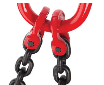

Chains really need an end connection to properly form around the end chain link. Like the red links in this photo. And the design by StrcrPono above.

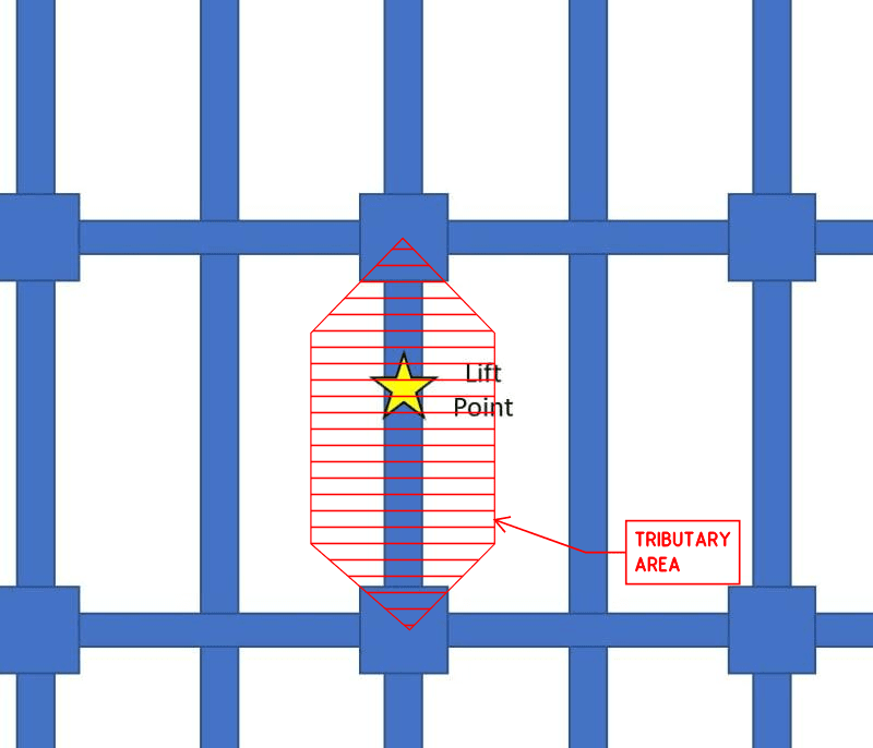

Ingenuity - thanks again for the detailed response. For "option 1", could you confirm how you calculated the 18,000 lbf dead load? I assume it is the beam weight + slab weight, using a typical concrete density. I've included a quick sketch of the beam geometry - would the tributary area be the beam span x the beam spacing, or is it decreased due to the contribution of perpendicular members taking some of the load?

For the example I gave - assumed to be what we call a one-way beam-and-slab system - it is simply the cross-sectional area of concrete (in ft2) over the 10' assumed width x span length, so SW = [10' x 6"/12 slab + (12"/12 beam web depth) x (12"/12 beam width)] x 20' x 150 lb/ft3 = 18,000 lb.f
For your actual case with perpendicular beams the tributary area gets reduced slightly, as follows:

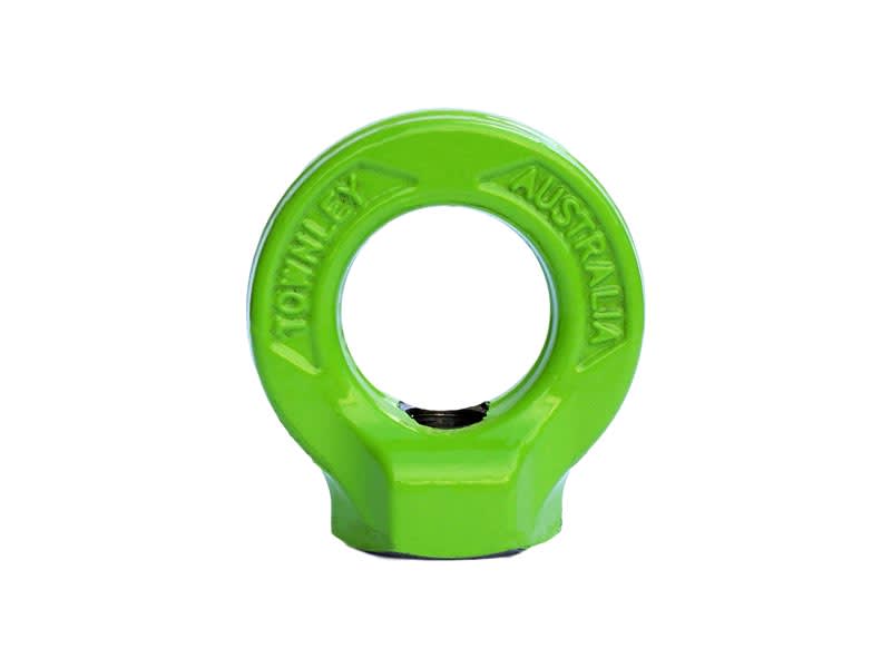

I’d grout fill the voids, then use a rated eye nut plus plate washer on each side, then connect the chains to the eyes with rated shackles.
