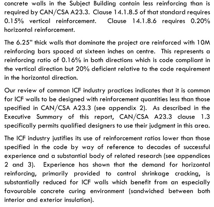

I received an update from the Logix Head Engineer in Canada regarding this question:
- Unfortunately, the National Building Code limits ICF walls, unfairly, to 5.5” minimum. That means any ICF wall less than 5.5” by code it has to be designed to part 4 of the code, which in turn says to design to CSA A23.3.
-In previous versions of CSA A23.3, we were permitted to deviate from the design code if we can demonstrate the rationale behind it.
- However, because the concrete in ICFs are perpetually insulated, thus in a good curing environment, we increased the spacing (any cracks that do occur in the ICF will not be visible or structural). This is common practice and is allowed in the residential codes in the US (up to 48” spacing), and is noted in the Logix Design manual.
