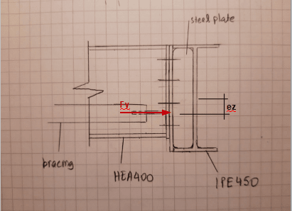

I am trying to check a connection between a HEA400 and a IPE450 and I have the following question, see also the attached sketch.
The diagonal of the horizontal wind bracing is connected eccentrically to the HEA400. The force in the diagonal gives two components. One parallel to the HEA400 and one parallel to the IPE450. The component parallel to the HEA400 gives a bending moment M=F*e which should be taken by the HEA400 and the connection. The component parallel to the IPE450, normally gives a torsion for the HEA400. Is this torsion transmitted as bending moment to the IPE450? Should I check both HEA400 (with that torsion) and the IPE450 (with the bending moment)?
Thank you in advance for your response.
