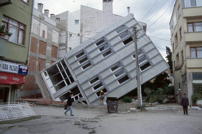

I'm making some assumptions now, but I'm pretty sure the building owner (Turkey, 1999) of the image below saved some money on liquefaction mitigation.

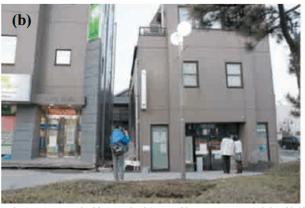

you have seen one example from ATSE above of a liquefaction failure below is an image of another potential consequence. The building on left has piles and the ground settled 40 cm, the building on the right settled an additional 30 cm into the ground.
Is it a "must?" only if you don't want the building to fall down or settle in the event of liquefaction.

The tilted building looks like it was overdesigned...
