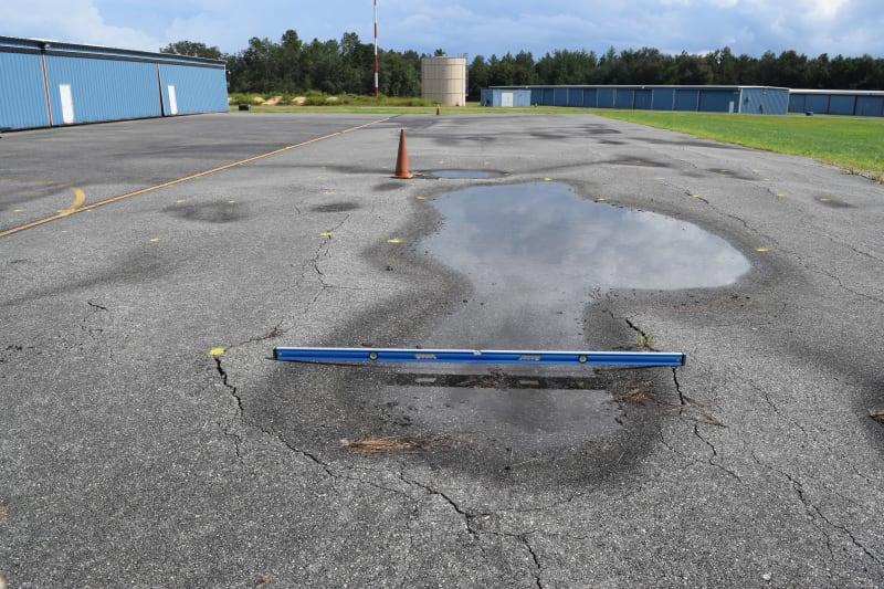

MM....the expansion is highly variable and often would not show in a typical short-term swell test. This is an asphalt apron at a small regional airpark. The material was used to stabilize the subgrade. It pushed the base and surface up in many locations, creating a propeller strike hazard. It was also used beneath the building as fill and pushed the two hangars floor up to the point that the doors would not close properly. We did the investigation for the airpark authority and testified in the trial, which my client won. This is just one of several I've done over the years. The expansion rate and magnitude are not predictable.
p.s., in CCB (coal combustion byproducts) avoid at all costs any additives that contain Sulphur. Adding lime can work, some of the CCBs are pozzolonic, but any Sulphur can lead to ruin - or at least be understood.
CCBs are typically unmineralized. They are often basic and the presence of CaO (free lime) can allow for remineralization and added strength.
When Sulphur is present; however, the Sulphur will join the party, find moisture and form ettringite or other minerals of that ilk. That's a huge and expansive problem.
Then again, you may not have such issues to worry about. Here in Central Virginia (USA), we had a big flock of lawsuits over this matter, about 20 years ago.

f-d....we did testing on the stabilized subgrade material and found ettringite. That was my first tip-off on this one. Then looked at free calcium and magnesium.
Thanks for the practical demonstration Ron- pictures speak a thousand words.
