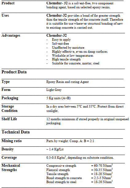

Referring to the type of epoxy having 60-70 MPa compressive and Having more tensile strength than the concrete, while that of concrete strength is 20 MPa. So what would you think about this type of epoxy, won't it work. (Picture 01)

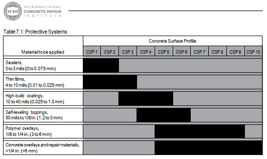

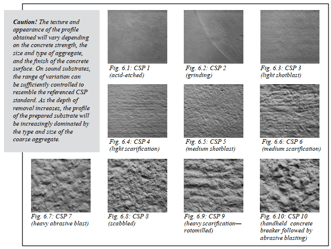

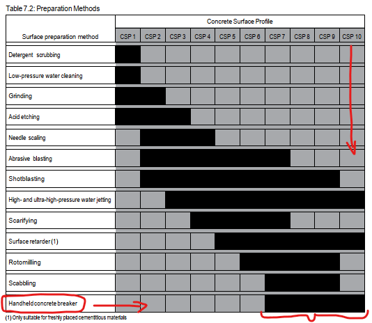

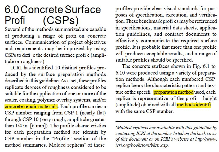

For concrete Surface preparation for shear friction where applicable using Guideline No.310.2R–2013-Selecting and Specifying Concrete Surface Preparation for Sealers, Coatings, Polymer Overlays, and Concrete Repair is the right procedure for achieving 1/4" amplitude surface roughness? to give µ(friction coefficient) = 1.0
Concrete surface preparation method for 1/4" amplitude surface roughness, Concrete surface profile (CSP 10) is ok?
I have given you my opinion about bonding agents. They are unnecessary and potentially can function to decrease bond.
Rather than bond, you want to rely on mechanical shear transfer. The key and dowels should suffice at the point of minimal shear. If you want additional insurance, shot blast the surface as in your figure 6.3 or 6.5, and ensure the surface is clean of dust and contaminants.
