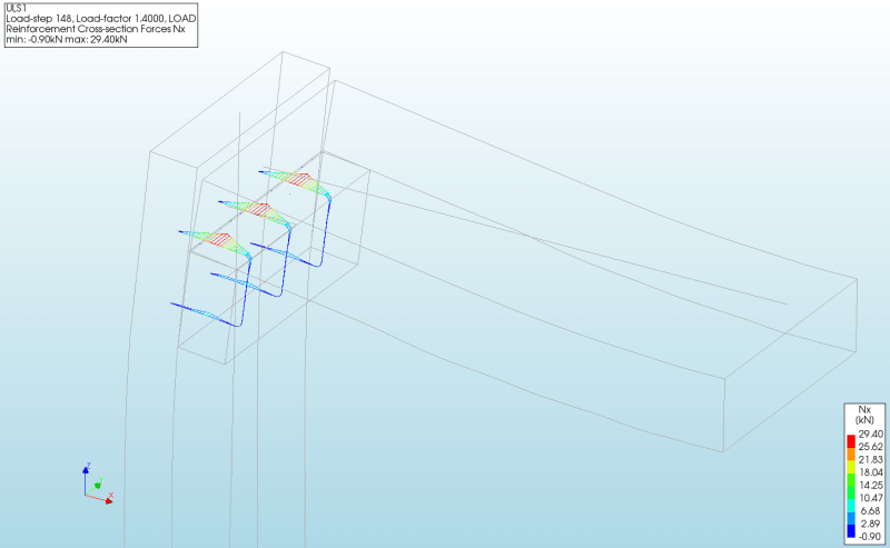

I was asked to offer an opinion on the suitability of the detail below. They are planning to build a tunnel adjacent to the existing building. The tunnel will have a slab over it that supports 900mm of soil. I was only asked to comment on the continuous slab ledge. I would prefer to see a 40mm bearing surface for the new slab, but they are not too interested in changing the detail. In general the numbers do seem to work, but reading Joel's thread I thought I should seek others opinion on the field drilling/epoxy anchorage.

2. Pin wall head. For the forces to increase as you described I had to allow the slab to deform laterally in the XX direction. Given the slab will be supported on a new wall right of the sketch, I am not sure this would happen. Nonetheless I ran the model, and the force in the critical tie would increase from 21kN to around 29kN (sketch below). This is not feasible as you thought.

With a bearing surface for the corbel, the force in the critical corbel tie drops to 3kN each (model) and approximately 5kN each with a simple hand calc. In the model the interface used has a shear component between the corbel and wall face, and hand calc does not. While the detail is still not great, I am not sure there is a technical reason it does not work. If I were faced with the same problem at the design stage I would have likely used a larger bar and tighter spacing if I could not persuade them to add a new wall. I like a safety margin equal to about 3-5 for something like this.
