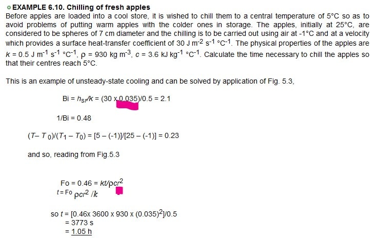

300-400w/m2/degK for ho on the surface of the mango with air as the cooling agent? That must be way too high.
Yeah so i think this is exactly what makes the h convective so high, high velocity means high Re means High Nu means High h. Maybe in a fridge especially when the fruits are arranged in a big pile i can assume natural convection like 30[W/m2*s] . the air goes out from the fan at 2[m/s] maybe but doesn't reach the fruits at that intensity .

Characteristic length of a sphere is not D/6? means V/A. Don't know why they are using r here for Bi and also for Fourier number.
Also after i found the temperature in the center , how can i find the distribution inside the fruit?, Since at the end i want calculate the total heat transfer from the apples Q=mCp(t2-t1). And the temperature t2 is not uniform inside.
**For this i found "Heisler charts" i think its good
Thank you very much

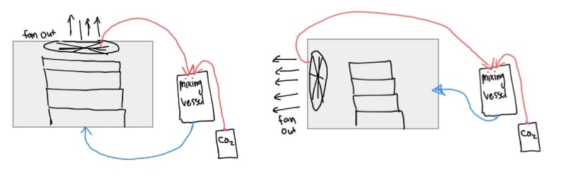

i want to discuss now about the setting of the cooling system. So our cooling system consists of a vessel that mixes air with Co2 and discharges a cold air( with extra co2) . The maximum power of this system would be discharging air at -20c at a flow rate of 300[liter/min] .Of course in the future we can change the size and the power of the system . So first of all my idea is to use the air from inside the tank to mix it with the co2, because it's cooler so I'll need less energy for that. Then how to locate the pipes coming out from the vessel, whether from the side or from the bottom .And installing a fan with the same amount of flow rate on the opposite side. I can also stretch pipe lines inside the tank in between the fruits packages. I will draw the 2 sketches :
Any other thought on the system would be appreciated , thank you very much.
And btw the fruits eventually going to be arranged in boxes with small gaps in between .
