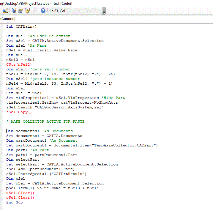

Hi Gents,
I'm trying to find a way to copy the axis systems from each of the parts in a product and put them in a single part file and rename each with the instance name.
I haven't had a go at any batch macro's yet so any pointer would be a big help.
I'm not even sure this can be done so don't laugh :)
regards
Alan
Also, is this in VBA or CATScript? I'm getting some red word's and wondering if it's because I'm using VBA. Thanks!
There are no error trappers, loose checks but it can be easily adjusted.
- It works in my setup (CATVBA, V5R21, Win7 64bits).
- It copies from multiple instances of the same part with respect to relative position within the assembly.
- It goes recursively to all levels of the active Product.

Hi Aaron,
It's catscript.
I cant run macros on customer sites so I have to use scripts from a usb :(
Well, I just put that code in a CATScript and it ran flawlessly.
Did you try it?
Calin
Oh, sorry, you were talking with Aaron. My bad [bigglasses]
