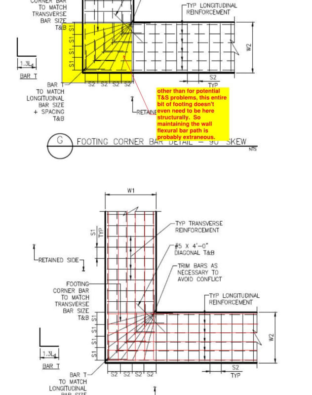

I am sure that I am over thinking this corner detail. The footing has multiple bars,I understand the basic idea to tie the inside bar to the outside bar with L bars doing 90s, i am drawing a blank with how to connect the other 6 bars in the corner.Would u bars work better in this application, or is there not enough room for error/ working in the field with the relatively congested detail.

JeffG1 said:
This question is as simple as how to transition the interior 6 bars(purple lines)through the corner. I will use the corner U bars.
The question is anything but simple. And that's your fault owing to the fact that you never bothered to tell us enough about your structure for anyone to be able to help you meaningfully. Is this a moment resisting footing? Just gravity? Are the bars that you're concerned about primary flexural bars or just temperature and shrinkage?
In my opinion, the corner U bars are ridiculous for this situation at 6' wide across the U:
a) the bars will have no stress in them at all anywhere near the middle of the flat of the U and;
b) by discontinuing the bars between the U bars as you have, you set yourself up for some big temperature and shrinkage cracking needlessly.

I liked it enough that I saved it for future use. To some extent I respect the clear detailing irrespective of whether or not it's technically correct. It's quality presentation.
Truly, however, I don't feel that the fanning bars need to be primary structural reinforcement, even in a retaining situation, per the first sketch below.
So long as the bars in question are T&S, I favor the layout shown below. Dirt simple and should provide plenty of crack control across the knuckle.
hokie66 said:
U-bars have been shown by testing to develop more of the capacity of opening joints.
How would that look in real life? Wrap the horizontal rebar in a U shape around the last two vertical bars?
