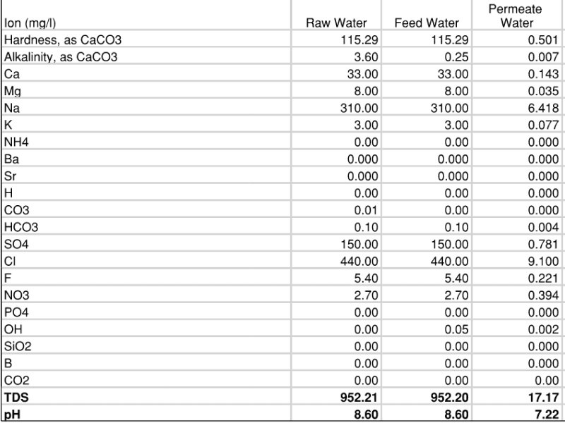

Thanks for the responses. Below is a table indicating raw and post-RO parameters (from RO vendor's modeling). The final RO pH says 7.22, operators have noted permeate pH of between 6.8 and 7.4 from the existing RO they have. There is no CO2, and there is very little alkalinity. This is indeed a very small system, the RO is anticipated to run at ~60 gpm (permeate production). I will take a deeper dive into the paper @bimr linked this evening, but it looks like they show CO2 pre-dosing like I mentioned in Figure 3.

The water analysis is a little suspect. You are showing 98% RO rejection which is on the high side. Is this a 2 pass RO? Do you need 100% RO throughput to meet your water quality objectives or can some of the raw water bypass the RO? If some of the raw water bypasses the RO, it will help with the remineralization.

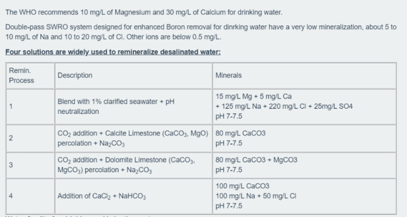

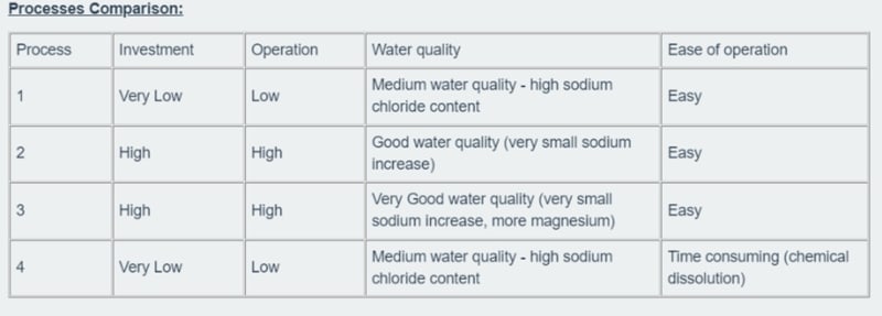

The table below provides some other alternatives that can be used. The capacity of the system and the skill of the operators should be used to select the appropriate system.
The 3rd alternative is probably the best, because it adds magnesium as well. Dolomite filters are probably more common in the Middle East where desalination is more common.
Lenntech
Dolimite Filter
