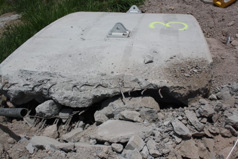

The precast section above failed in sudden flexural bending during installation. It was 350 mm thick and quite heavily reinforced on the bottom face, which would have been in tension in the completed structure. There is nothing mysterious about the failure mechanism:
[ul]
[li]The load factor during handling is only the dead load factor x whatever is assumed for the dynamic load factor, which is not well defined. It is certainly much less than the load factor on the lifters, even though the consequences of failure are the same.[/li]
[li]Differential thermal stresses can be enough to generate tensile stresses in the concrete of the order of 2 MPa, which will reduce the cracking moment by half.[/li]
[li]When the applied bending moment exceeds the concrete cracking moment the stress and strain in the steel are close to zero. The section deflects and gains significant momentum before the stress in the steel is sufficient to start to restrain the falling concrete.[/li]
[li]The combined static moment (which was sufficient to crack the concrete) and dynamic moment cause sudden failure of the reinforcement.[/li]
[/ul]
In this case the top face reinforcement was low ductility mesh. If it had been normal ductility bar that might have had sufficient ductility to prevent total failure, but the section would have been rendered useless anyway.
The circumstances that combine to cause this sort of failure are fairly rare, but not so rare that the potential consequences can be ignored. In this case luckily no-one was standing undereath when it failed.
