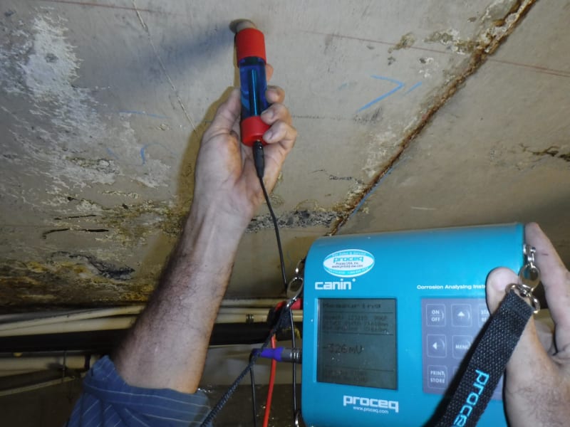

1960's structure, partially exposed to elements, T & B rebar with thin slab, existing cracks with efflorescence and (possible) rebar corrosion ==> maybe half-cell corrosion mapping is warranted...and check if the roof membrane is compromised because efflorescence may indicate that there are issues.
Ingenuity - with the half cell mapping, how do they come at the rebar? Do they just go up through the crack or core out an access point? I've never seen it done.
I don't know the mapping method, but I doubt there is only a single layer of bar mat, and the slab was designed as one way continuous beam. 5" is too tight even for WWF.
We usually just do a small concrete chipping probe at a rebar (where a crack is located, or GPR scan) to make an electrical connection. I do another probe to rebar at the diagonally opposite end of the map area and check for electrical continuity across the connected rebars.
Half-cell testing is covered under ASTM C876 Standard Test Method for Corrosion Potentials of Uncoated Reinforcing Steel in Concrete - not a perfect test my any means, but supplements a visual and tactile inspection.
