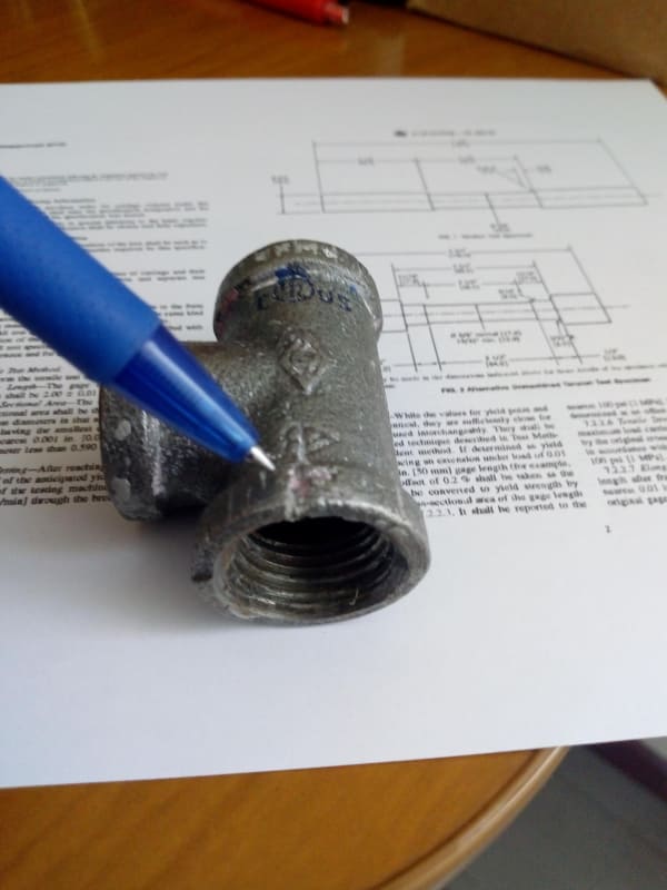

Hey guys. In a construction project we were facing some problems with some malleable iron threaded 90° elbows. During some pneumatic tests two elbows failed (I attach some picturees). We think that the problem is bad practise during construction by the contractor (due to excessive wrenchs marks). However the client is asking for a deeply root cause analysis with emphasys in the material properties. We got some quality certificates of these material but are too basic (most of them just say that mechanical properties met the requirements of ASTM A197. 90° elbows are class 150 and correspond to ASME B16.3 fittings). I was thinking to send the failed fittings to a laboratory for metalography test (probably to check microestructure if everything is OK) but I am not sure if it could be enough.. I would like to know if with this failed fitting can I get some tensile test.. I need some advice of you guys that maybe have much wide experience in these fields!!

Have seen this before and assumed it was from massive over-tightening. Good lord some of those monkeys don't know when to quit turning the wrench. It's either that or they forget the pipe dope and figure they can "make" it seal by giving it an extra half-turn. Curious as to whether you found any tape or compound in the joint when it was taken apart?
Yes I found tape in both threads. However the point is that my client does not believe that the contractor could have the fault. That is why i am here asking for some advice, so I can test failed material.
Oh I forgot to mention that we had problem with a T, too. Maybe it is the reason why my client thinks that the material is poor quality.

Interesting that the wrench marks are on the end that didn't fail.

The elbow is a sand casting with several surface defects seen . It instils a low level of confidence in the product. As was rightly pointed out by others ,it may be a cause of over torquing .
In one of the pictures I could see the colour of the fracture surface to be gray,which should be ok. A metallurgical analysis might give a better picture about cause of failure.

Root cause? Over-tightening due to a threaded pipe section that was not to spec. I.e. they let the new kid run the threading machine, and he ran the threads too deep/long, so that when the fitters went to make up the joint, they had to wrench it "extra tight" to get it to seal properly. When you do this, then end of the pipe runs out into the bottom of the threads, and the wedging action of the taper can drastically exceed the normal forces on the pipe wall. Get a 1/2 NPT ring gauge, and check all of the nipples/pipe ends to see if the failed fittings came off of defective (overlong) threads. Make the contractor come back and replace the defective pipe sections.

The longitudinally-oriented cracking indicates hoop stress exceeded tensile stress either as a single event or under cyclic loading. That is more characteristic of overpressurization on the inside of the fitting. Overtightening will most typically either induce circumferential cracking at the base of the threads or angled cracking from the resolved shear stress.

Hmmm, I've seen a lot of "popped" fittings in my day, and the ones that get over-tightened look exactly like the example shown. An analysis is definitely in order with the client claiming what they are. Contractors will always blame "insert any reason or excuse here" rather than admitting that they did something wrong.

The pipe wrench scars on the other joint of the elbow show excessive force was used while turning. Also, clamping that end of the elbow might have been the "resistance" torque holding the pipe_1 & elbow as the new pipe_2 was twisted and over-torqued.
I agree that this crack is entirely consistent with what you would see from over-tightening. The crack is widest at at the end of the elbow where it is thickest and the only load at that point is from the pipe threads and not internal pressure. Perhaps not everyone is aware that pipe threads are tapered and that over-tightening expands the outer fitting until it bursts. It is a very common problem, particularly with cheap, thin-walled fittings.
There is a hoop stress component to tightening that adds to the hoop stress from internal pressure from the pneumatic tests in terms of overall tensile component of hoop stress that is required to drive that longitudinal crack. At the same time, I think a lot of tea leaf reading is going into interpreting the meaning of the wrench marks - they do not necessarily mean overtightening. There are a range of potential root causes for this longitudinal crack - you would need a lab investigation to figure out the correct one and/or eliminate others.
