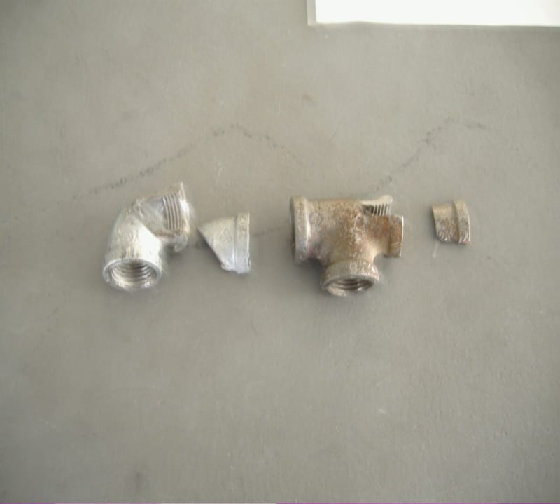

Hey guys. In a construction project we were facing some problems with some malleable iron threaded 90° elbows. During some pneumatic tests two elbows failed (I attach some picturees). We think that the problem is bad practise during construction by the contractor (due to excessive wrenchs marks). However the client is asking for a deeply root cause analysis with emphasys in the material properties. We got some quality certificates of these material but are too basic (most of them just say that mechanical properties met the requirements of ASTM A197. 90° elbows are class 150 and correspond to ASME B16.3 fittings). I was thinking to send the failed fittings to a laboratory for metalography test (probably to check microestructure if everything is OK) but I am not sure if it could be enough.. I would like to know if with this failed fitting can I get some tensile test.. I need some advice of you guys that maybe have much wide experience in these fields!!
Any help will be helpfull.
 https://files.engineering.com/getfile.aspx?folder=fee9e0bf-7448-4a74-a5fe-1a6103eb7061&file=IMG_20171222_113333.jpg
The wrench marks on the fittings are the big clue. There would be no need for aggressive tightening on pneumatic service lines in 1/2" NPT, unless something was amiss. As Ornery and Cpro (and I) say, the cracking shown (longitudinal) exactly matches the failures we have seen from over-tightening tests we have done both for outside fittings purchased as well as our internally produced threads, both internal and external. It's the most common failure mode for tapered pipe threads. I've never seen a circumferential crack in a threaded (taper) pipe fitting. I'd not waste a dime on external consultants, but then it's not my project nor my customer.

Looking at the crack it appears to be caused by a hoop stress component which would be present normally under internal pressure may also be caused by other reasons mentioned by others. Was the installer given any instruction relating to the fittings being tightened? Or are they deemed experienced contractors who do these installations regularly? The reason I ask if it was poor installation and these installers were rough, I would of expected more to fail from being over tightened in the quantity of around 500 you state if the installers were doing a bad job.
Either way if you are intending claiming from the contractors then you need to get independent proof as to what did or didn't cause the failure and it also helps if you can show that installation instructions were given to the contractor and they weren't followed.

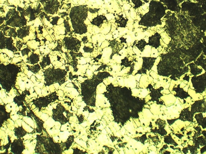

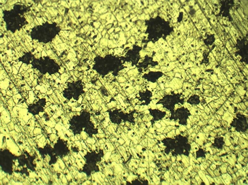

Hey guys.. well I wanna tell you that I made some tests over these two samples and I am going to summary the results:
- Hardness test in both samples: (average value is 75 HRB.. 133 HB.. estimated tensile strenght 45.6 Kgs/mm2)
- Metalography:
Pictures shown in 200x microscopy.

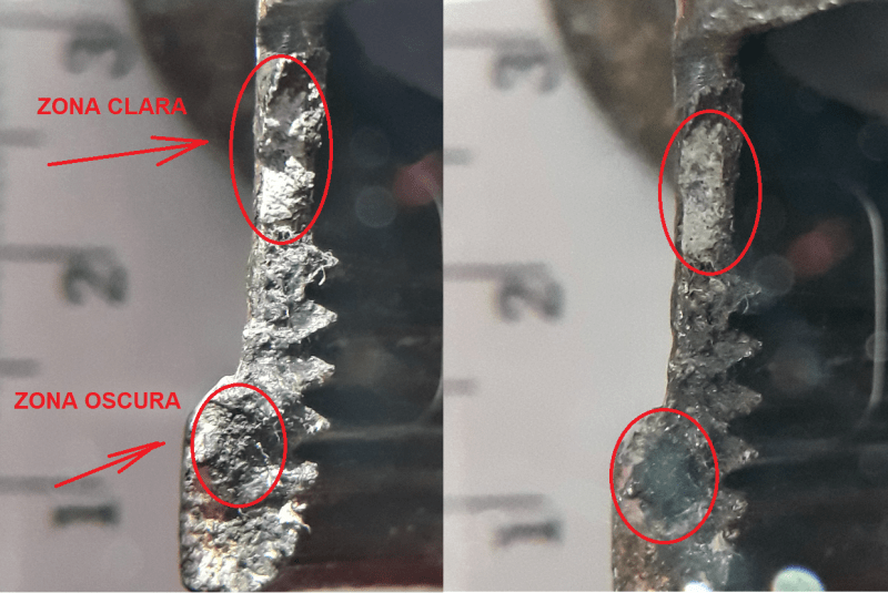

Following the issue comment several months ago, I got some pics from fracture zone of Tee fitting.
In this section clearly appears a "White" zone and a "black" one. I guess these could be some inclussions.. what do you think about that?
You will not see inclusions on these fracture surfaces unless they are grotesquely large. Generally there is little information to be gleaned from a cast iron fracture surface.
If you are seeing a mottled fracture,,, it indicates a poor malleabilization. The original white iron has not transformed into malleable iron.
But again,, I wonder if this can e true for such a small castings,unless the foundry has very poor controls.
