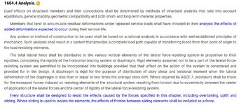

I've seen a lot of repairs "done" on paper, but I'm also, conversely, not aware of any established testing that routing out the grout and redoing it restores the required strength, if you want go down the "well-established principles of mechanics" route. (someday I'll have that phrase committed to memory, until then, there's the downloads folder on my computer.....).
