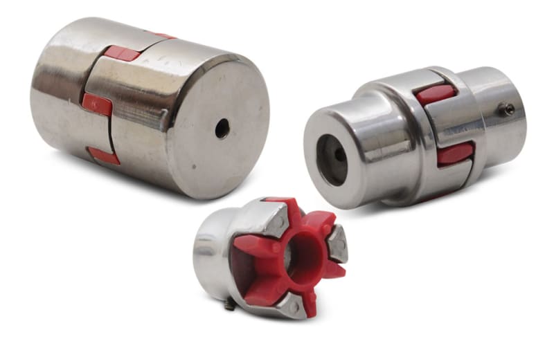

Cast iron jaw coupling in a hoist? at 3.24. This might be allowed under the design rules for a light duty crane, but specifying a light duty crane in a turbine hall where the load can easily be worth much more than the crane seems like an unwise cost choice (not even considering the safety aspect).

The failed part looks (to me) like a jaw coupling, which is a part I would expect between the hoist motor and the hoist gearbox.
The lower grade of these couplings is made from cast iron, note the brittle fracture surface. These couplings can be obtained in steel, which is less likely to fracture.
It is unusual for a crane of this size to have a mechanical load break, so failure of this coupling results in complete loss of load control, but the load will accelerate slowly as it is still connected to the inertia of the gearbox. I would expect much faster acceleration if the hoist rope failed.

Only one of 4 teeth on the jaw coupling broke. This would not have caused the load to drop.
There are more broken pieces than just the jaw coupling, it is not obvious what they belong to. Perhaps a bearing housing supporting the coupling??
Yes, an extreme misalignment between the motor and gearbox would break the coupling in this manner. This coupling failure is a result of the load dropping, not a cause.
The jaw couplings for the container cranes I have worked on were typically GGG Spheroidal cast iron. Its also common to have redundant brakes, typically 1 on the motor side and one the low speed side of the gearbox.
