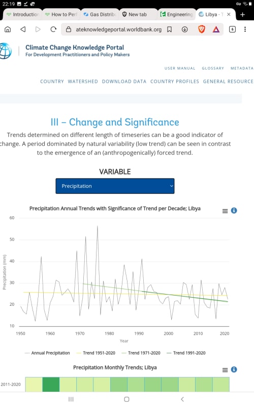

AZPete, I am leaning towards believing that the dams were sized appropriately for their time using the available data of the day. Total capacity seem to be around 18Mm3.

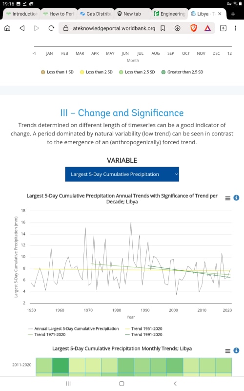

I've seen the data for 1900 to 2021. There was no reason to expect that a storm of this kind would ever affect Libya. It was probably a 10 to 30x average outlier. No 5-day total rainfall in Libya ever exceeded 16mm. This storm apparently hit with 100mm in a few hours. Maybe considerably higher due to local topographical conditions. A true black swan.

Here is the rainfall data summary I found.
See if you draw the same conclusion.
Yearly average is around 25mm, max ever 55mm.
5day rainfall total is available apx 8mm, highest ever 16mm.
10mm on a 157km2 basin at full 100% runoff, not very likely, but still, is 1,57 Mm3.
25mm is apx 4,0 Mm3
100mm is 15.7 Mm3 50% over max ever recorded yearly rainfall.
Assume the 55mm yr total is 1 in 100yr event, that's the data right there.
55mm 8.63Mm3, worst yearly max ever.
50mm is a 50year yearly rainfall total event, we saw 2 in that range in 100 yrs of records.
40mm is a 20-25yr frequency.
25mm is a yearly frequency.

Keep in mind those are yearly totals. Not convertible to dam capacity, which might, I don't know exactly, only be 25% of those numbers.
55mm, 100 yr total rainfall 8.6Mm3 might represent something like 4 x an actual dam design capacity and they have 2 x that.
1 year totals are very much different than 1 day totals. It's totally unreasonable to expect to get 2 x a worst case year's rainfall in a day, never mind a minimum of 4x that in a few hours.
Yet the dams could hold that much.
I don't really believe the downtrend lines. It's flat. Only the computer thinks it's a downtrend.
2022 and 2023 are missing, so that will only kick it up, not down.
The possible maintenance issue is a separate problem. I only wanted to know if the designers blew the capacity number. I think, certainly not. No such storms were ever recorded in the history of the region and I believe this storm was not even predictable as an extreme black swan. Its rainfall was far greater than 3 σ.
