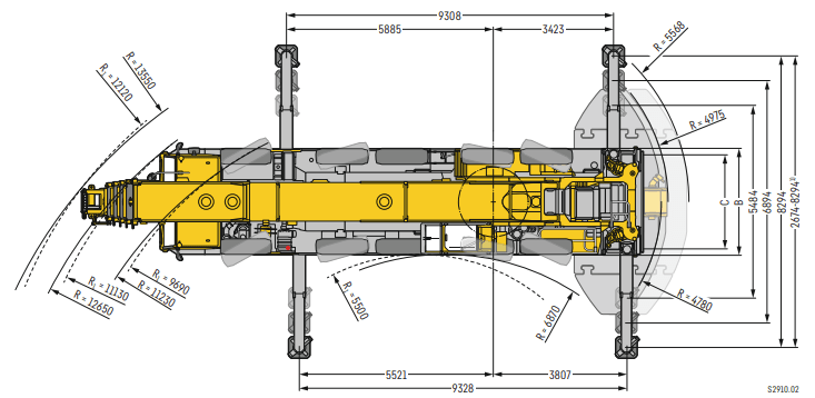

Hi, does any one know to draw mobile crane turning path without using AutoTurn. The crane model is liebherr LTM 1250-5.1.
Thank you 😊
This probably the same info that CarlB shared but page 3 has a nice little picture of the crane showing all the radi and their locations on the crane.
Liebherr Technical Data Mobile Crane LMT 1250-5.1
Not sure if it's a one-off for you to figure out the turning path, but we used to do it the way dik recommended until it got very tedious with all the facilities we design so we invested in the vehicle tracking swept path software.
