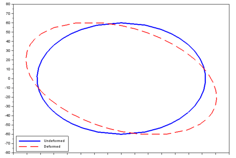

Here's an example - I analyzed torsion of elliptical bar in Abaqus, then followed the procedure described above and generated plot in SciLab. It required some effort due to the need to clear the data but here's what I got in the end:

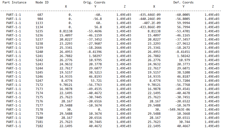

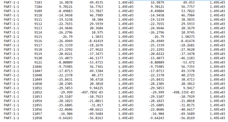

Thank you for your effort, while your response is very clear I believe I am having a technical issue, tried to plot the cross sections with python Jupyter notebook, I can do this for original coordinates but not sure if I get correct nodes for the deformed part. The report file I get has two sets of data points. Not sure which stands for original/ deformed coordinates because they give dubious results in my findings.
For instance, after creating a display group (under visualization module, by selecting nodes on the deformed shape), I perform Boolean operator to display only those selected nodes, and these sets of nodes (in the report file) are having different number of nodes:
Second set of node coordinates which has different number of nodes (Which one stands for deformed nodes?):

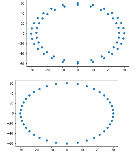

And here is the scatter plot I get:

Those three columns (X,Y,Z) above which there’s a label „Orig. Coords” contain undeformed coordinates while columns with „Def. Coords” contain deformed coordinates. Make sure that the deformation of your cross-section is high enough to be visible when you plot it from these points (check it on the deformed shape contour plot in Abaqus with deformation scale set to 1). You may also increase the precision (number of decimal places) when you write this file from Probe values to see the differences between original and deformed coordinates.
Hello,
Deformation is highly visible, I select esp. those nodes in view cut to see the difference right away.
In my abaqus.rpt file I get both "orig cords". and "def. coords" same. (Always getting original shape).

To avoid this error switch to Plot —> Undeformed Shape.
It may look like a high deformation but make sure that the scale of your deformed shape or contour plot is not higher than 1. You can check this in Options —> Common —> Basic __> Deformation Scale Factor. I think that this may be a reason due to the fact that the values of deformed coordinates are the same as those of undeformed coordinates, as you say.
