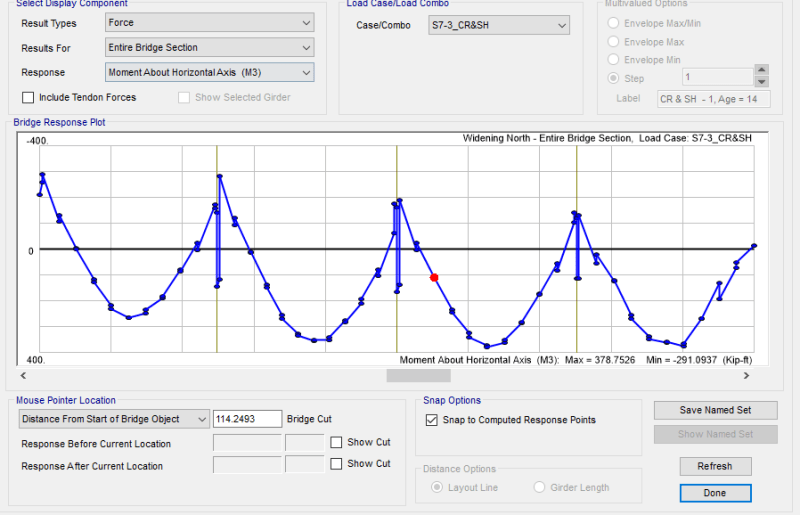

Hello Everyone,
Again I am asking about creep and shrinkage. I have been doing some research to be able to understand why as time progresses, my moment demand increases tremendously.
I am working on the widening of a 4 span precast prestressed bridge with cast in place Deck.
I am using CSI Bridge where I defined my concrete properties to be time dependent materials
I ran a stage analysis as follow
-Stage 1: Existing
-Stage 2:time lapse
-Stage 3: Abutments
-Stage 4: piles and Girders
-Stage 5: prestress
-Stage 6: 7 days for creep and shrinkage
-stage 7-1: Haunch
-Stage 7-2: Wet Deck
-Stage 7-3:Deck Harden
-stage 7-4: Creep and Shrinkage (7days)
-Stage 8: permanent loads
-Stage 10: creep and shrinkage (18250 days)

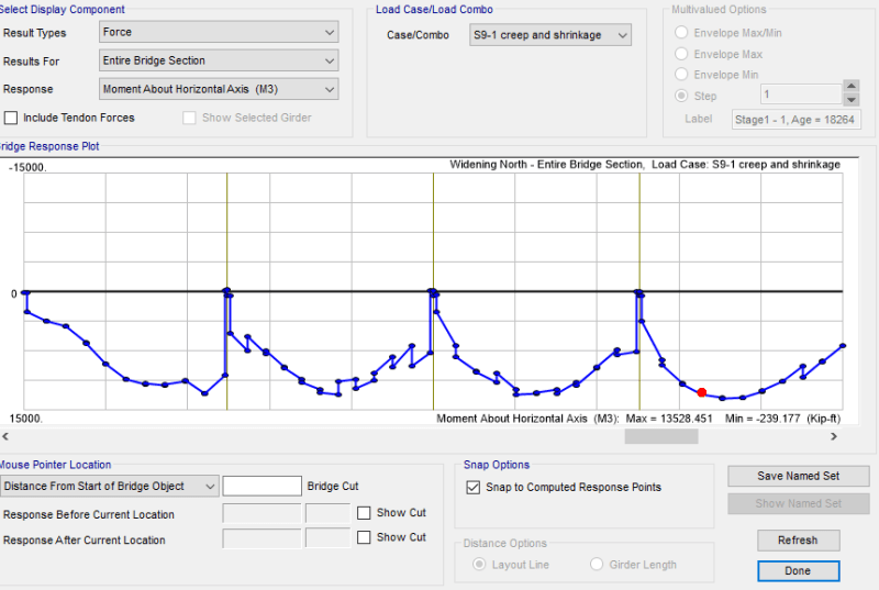

This is stage 6 results

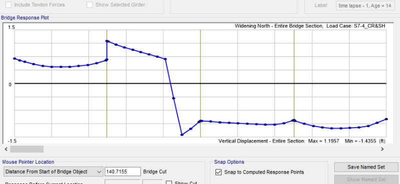

This is Stage 7-4

I don't have experience with CSI Bridge as we use another FEA program.... but I imagine that the program is providing you the summation of forces at the end of each construction stage. For instance, your forces that are showing for Stage 7-4 are the summation of all forces with respect to time as opposed to just the forces due to creep and shrinkage? Either way, it's obvious that something is very wrong. Your moment diagram over Pier 2 is nearly -40,000 k-ft which is insane. Whenever I have issues with Stage Construction Analysis, I start slow. Take it one step at a time. Don't rush into modeling the entire bridge with all stages and time dependent constitutive models and materials. Turn on your elements and boundary conditions for Stage 1 check to see if the forces, stresses, and displacements appear correct and then save that model. Add Stage 2 and then save that model.... etc. It's hard to debug a complicated problem and starting slowly can help.
What does your displaced shape look like for Stage 7-4? This will probably tell you whether or not your boundary conditions are incorrect. I also am unsure what the boundary conditions of your bridge are? Are all girders simply supported with expansion/fixed bearings? Do the girders become continuous after deck pour and cure? Not related to your particular problem.... but I am assuming you are not connecting the decks right away and are rather utilizing a closure pour after the widening is complete?

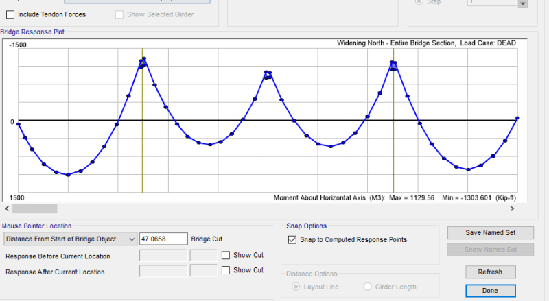

I agree that the forces are summation of other stages. I did check the model through running linear dead load case and it seems to me that the moment diagram is reasonable. You will notice that there is some negative moment at the support but this might be due to continuity links I provided at the slabs to model is as continuous.
Looking at the displaced stage seems to be huge. I will recheck my boundary conditions. The girders are simply supported and so the boundary conditions are pinned at each end in the longitudinal and transverse directions. The deck is only continuous after the concrete is cured.

Based on your displacement model, something definitely happened to your boundary conditions. It looks as if you lost vertical support somewhere along the way. Your linear dead load analysis seems as expected. Based on that, I would think that a boundary condition got deactivated or an unwanted one activated at the wrong stage in your analysis.
Check that and let us know if you found any issues with it.

I was able to find the issue. The problem was with how the concrete pour was defined in the stage analysis.
I noticed although my creep and shrinkage right after the deck is cured, seems to be reasonable now
On the other hand, I applied creep and shrinkage also after the whole bridge is modeled and the permanent loads are added with a duration of 18264 days, and it seems to be out of the way. However my thoughts are if creep and shrinkage at this duration is valid. Meaning they are time dependent, so couldn't it grow indefinitely; so If I will be looking at creep and shrinkage years ahead, I shouldn't be looking at the moment but just the deflection. What is everyone's thoughts?
