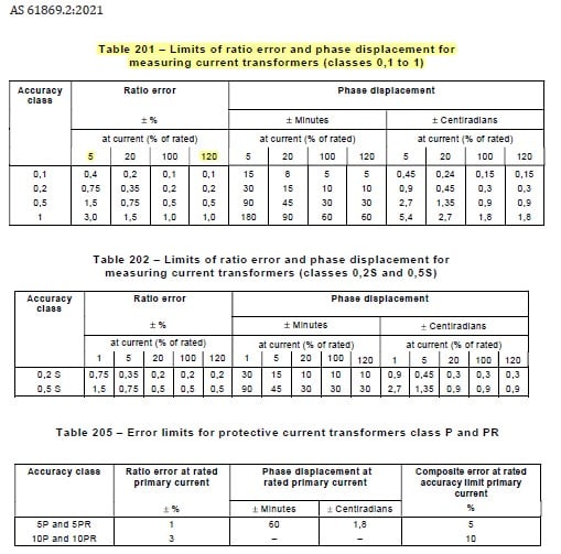

If I select a 600:5 CT with a 2x thermal rating, the CT has to measure 2% (12A on the primary) current in the reverse direction. The typical relay class CTs start to measure accurately at 5%. So my questions are:
1. Can I use a metering class CT rated at 600:5 that can measure with 0.5% accuracy between 1% and 300% of the rating?
2. I am not planning on using any other protection function in the relay, so is a metering class CT ok in this case?
3. Is it required by any code or standard to use a relay class CT for all the protection elements? In this case, it makes more sense to use a metering class CT as these are accurate in the low current ranges.
4. If there is a fault on the switchboard or downstream, I understand that these CTs would saturate. But I am not planning on using these CTs for any other protection. So once the fault is cleared and the system is back to normal, would these CTs have any issues measuring the low currents or reverse power?

AS/IEC standard 61869.2:2021 for instrument transformers quotes standard metering CT accuracy in terms of a ratio error from 5-120% of rated current. Higher accuracy class CTs go down to 1% of rated current. Of course, this is with an appropriate burden and power factor. By contrast, protection CTs only seem to quote the ratio error at the rated primary current. My understanding is that they are designed primarily to handle short circuit conditions without saturating.
Given the difficulty of accurately measuring such a low export power in an area of low CT accuracy, I would consider the ramifications. With such a large load, the utility fault level must be significant and it is difficult to see how a 10kW 3 phase export will materially impact voltage rise. Even 40kW of 3 phase export is only equivalent to 6.7kW (40/3x2) single phase export allowing for the factor of 3 and the additional effect of the neutral voltage rise in a single phase system. In Australia, hundreds of thousands of residential customers have been approved for 5kW inverters (on 400V line to line systems) without export restrictions, although V-Q and V-P restrictions have been steadily introduced.
If you do not have to test/prove the system and it is unlikely to impact on the voltage, I would suggest making a pragmatic CT selection that complies with all the proper requirements for burden, output voltages not exceeding relay inputs etc and not worry too much about the accuracy. The system will comply in intent.
