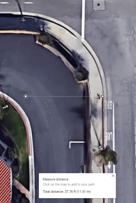

It depends on the anticipated vehicles that will be using it. Coming out of a parking lot or with primarily passenger vehicles perhaps around 15', on the corner of a normal City block 20 to 25'R, in an industrial park or other high-truck traffic it might be 40'R or larger. Typically each City or State Transportation Department will have their own requirements.

A 15 foot radius on the top corner of a municipal curb seems to me that would result in no discernible curve to the naked eye...or am I not interpreting this correctly
Ajk1:
Come on, read just a little bit between the lines here. Almost everyone is assuming you mean the curb or turning radius where two streets/pavements intersect, in plan view. If you meant any radiuses, when looking at a cross section through the curb, such as the slightly rounded corner btwn. a vert. surface and a horiz. surface on the curb, that’s another animal. Those shapes and exact sizes are controlled by the pavers formwork system, or by the concrete finisher’s edging tool. While the curb in a bldg. should probably be called out in a sectional detail, or may be controlled by the bull nosed tile you select.
Even with your latter clarification, I am still puzzled over the radius in question, is it the measurement for the round corners at curb cross section, or the turning radius of roadway. Either case, information can be found from the local/state D.O.T, and/or AASHTO specification/handbook for highway geometric design.
Perhaps even close to 40 feet:
