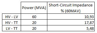

Hi prc! Thank You for the reply. Well, now i must confess that i'm really lost...if you could help i'll be very grateful.
The power transformer tertiary in this particular case will not be used for received any feed only for supplying the AC auxiliary supplies of the substation.
Regarding to the impedances and according to the power transformer rating plate the values stated are:
(the image is what is shown in the power transformer plate)
Thank you in advanced
mikenangel-
The individual winding impedances are calculated as below:
%H = (10.9+17.9-5.5)x0.5 =11.65%
%L= 11.65-10.9 =-0.75 %
%T= 17.9-11.65= 6.25 %
With a 3L on tertiary, there will be in feed from both H &L. Neglecting system impedance, it means H&L impedances in parallel with T impedance in series will be limiting fault current.
11.65x0.75/11.65-0.75= 0.8 +6.25 =7.05 %
So the fault MVA will be 100/0.705 =14.2 times the rated current. But actual rating of T is 20 MVA. So the If with a 3L will be 14.2x3=42.55 times rated current, too high. So to limit this to say 21 times rated current, you have to add a series reactor of 7% impedance on 60 MVA (ie 2.3 % on rated current of tertiary) base will be required.
Some references for you- Auto-Transformers for power system (AIEE 1954)Tertiary windings in auto-transformers (AIEE 1961) both by O.T Farry, a transformer designer with Wagnor Electric,St.Louis.
