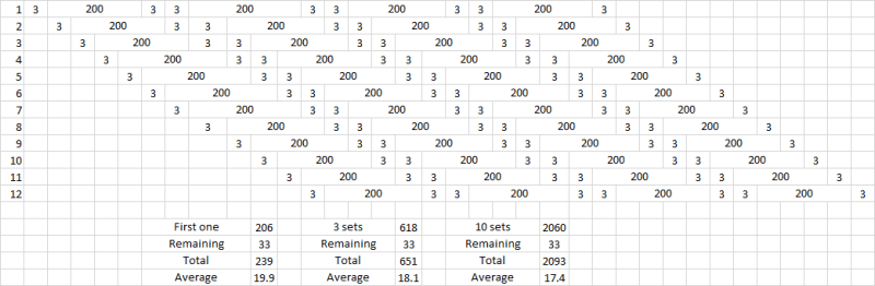

I have been faced with a challenge at work. I have a testing machine which has an operator to load and unload. After the load the machine operates automatically. Because the machine test time is high and we are unable to meet the Target Cycle time, we have made a machine with multiple cavities. In which case my operator will just load into multiple cavities but each cavity will operate immediately after loading, irrelevant of what is happening in the other cavities. This how the cycle time calculation is done.
Using 1 cavity
Loading - 3sec
Testing - 200sec
Unloading - 3sec
Giving CT per piece if 206sec
Using 12 cavity machine
Loading 3 sec
Testing : 200/12 = 16.7sec
Unloading : 3sec
Giving cycle time per piece of 22.7sec
But my team feel that the Loading and unloading time should also be divided by 12:
Loading 3/12 = 0.25sec
Unloading : 3/12 = 0.25sec
Giving cycle time per piece of 17.2sec
Below is a pictorial explanation of the situation.
Could you kindly advice please.

One slight modification, This will change if you have 66 parts in a row. At that point the operator will need to stagger load/unload activity and it will effectively double the load time for each part after that.
The real question is can one operator really load these every 3 sec, or will there be some additional time moving from one cavity to the next?
The test time for each part does not change, it is just a throughput issue.
As long as there is a supply of parts they will come off at the reload speed.

With a 12-cavity machine, they're stuck after 12; they have to wait 167 seconds before the first one finishes and they can unload, so if the machine is used continuously, it'll be (n*206+33)/(n*12), where n is the total number of dozens tested. As n goes to infinity, the average time is 206/12 = 17.2 seconds. Of course, this assumes the operator keeps up.

Thank you for the detailed explanation. From your calculation shown the below formulation would be suitable...
To calculate cycle time for a continuous production
Loading : 3 sec/12 = .25sec
Testing : 200sec/12 = 16.67sec
Cycle time per part : 17.2sec
But I assume that the operators time would be 6sec for every part.

Yes, the starting 3 seconds of the 2nd is pipelined immediately after the 3 second load for the 1st unit, and does not add to the cycle time, per se, only the last 3 seconds sticks out
t=3 #1 loaded
t=6 #2 loaded
t=9 #3 loaded
t=203 #1 cycle complete
t=206 #1 unloaded
t=206 #2 cycle complete
t=209 #2 unloaded
t=209 #3 cycle complete
t=212 #3 unloaded
total time is 206 for #1, 6 additional for #2 and #3, as shown in my first timing chart
