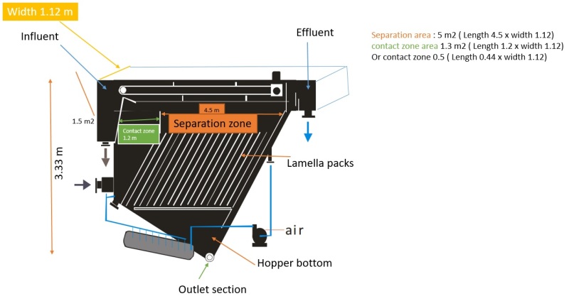

I put this parameters from previous your suggestion here , and here is my DAF -Sketch.
Thank you ashtree for powerpoint, I am trying to understand all, and here is something what I need to know exsctly :
From Powerpoint you attached file, do I need calculate
this Contact zone or is that desired length.
Also for my DAF, I want DAF design without bottom skimmer or Auger.
Example of DAF is like this one : Huber-Siltb
Here on Picture My_DAF_ dimensions are : Length 4.5 m, Width 1.1 m Height 3.33 m
for this dimension do I need put also dimension Length for separation zone as on this picture Contact Zone is showed from Powerpoint you gave me.
All technologies inside for DAF I don't need that ,as I only need to design this DAF.
Please provide me with information for this Contact zone - : is that desired length ?
You typically only need a bottom auger if there is a reasonable amount of heavy solids that settle out in addition to whatever comes up with the float. Given that you have chosen a hopper bottom even without the auger you may still require some sort of drain or desludging valve.
You have chosen a high recycle rate so your contact zone will need to be bigger than normal or your velocities and detention times lower.
With a flow of 50m3/hr 100m/hr contact zone vertical velocity you will need 0.5m2 of contact zone area or half that if you want 200m/hr.
Use a detention time of 1-2 minutes to work out the volume.

Also here on this picture where lamlella packs start and hopper bottom - is that all one size for height of DAF or from lamella packs to top ;
Kind Regards,
Sebastian
The contact zone is generally quite small with a velocity of about 100m/hr and detention time of 1-2 minutes.
Detention time= volume /flow.
If the volume of the tank is 100m3 and the flow is 100kl/hr(100m3/hr) the detention time is one hour.
In the contact zone you want a detention time of 1-2 minutes. At 50m3/hr the volume of e contact zone should be 0.8 to 1.6 m3. At 100m/hr velocity in the contact zone only the area will have to be 0.5m2 or less.

Here on my picture : I put orange colour - is that contact zone ?
- are they start from Lamella packs or from hopper bottom ( I can't find this informations in any book)
can I calculate detention time Separation zone like : Total flow / area , in my case 50 / 5 = 10 ?
Yes , the orange part is the contact zone. The 10-20mins detention time is required for the bubbles to adequately coalesce, cling to particles and rise to the top. In specialised cases you may be able to do this quicker but as a general guide that is the time required.
It will depend on a lot of variables but you will need to have the required detention time above the lamella. The lamella is really there to settle and collect heavier solids so is almost working independantly of the DAF. If you have many solids you may need to consider a collection auger because as soon as you open the withdrawal valve in the bottommm of the hopper you may cause all sorts of undesired flow paths.

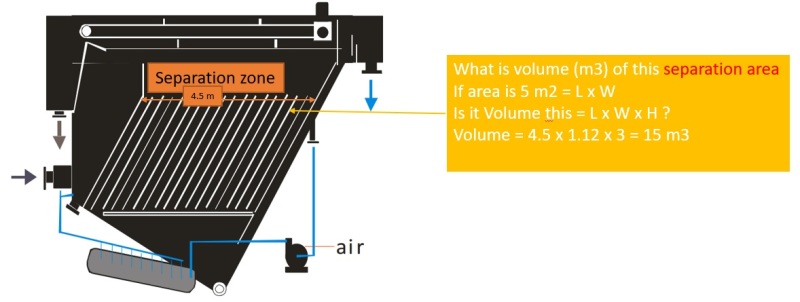

when they say : Detention time = volume / flow , so Volume is in m3 ( in that case all time I was wrong? that is not area m2 in my case 5 m2 ?
Volume = L x H x W in this case is it , height where is assumption 3.33 m
What is volume (m3) of this separation area
If area is 5 m2 = L x W
Is it Volume whis = L x W x H ?
Volume = 4.5 x 1.12 x 3 = 15 m3
Just to be clear
In that case from your calculate : If you assume 20 mins detention time and you have a linear vertical velocity of 10m/hr assumes that the liquid will travel upwards 3.33metres in 20 minutes
So Volume for tank area V = L x W x H , V : 4.5 x 1.12 x 3 = 15 m3
Detention time = Volume/Flow , Detention time : 15 / 50 = 0.3 , 0.3 x 60 min = 18 ( around 20 min) and 60 min / 18 (around 20 min ) = 3.33 m is this correct ?
Yes you are correct.
