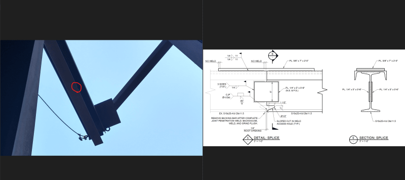

Attached is a photo showing some damage to the overhanging portion of a 4-ton S10x25.4 & C8x11.5 monorail beam, as well as a preliminary splice detail for a potential repair. I'm not sure how the bottom flange got damaged, but I caught it and need to do something about it. My initial thought was to cut away 4 ft of the beam to remove the damage and then splice in a new piece. Then I got to thinking that maybe there's a way to make the repair more localized to just the bottom flange.
My question is, does anyone have a creative way to repair just the bottom flange near the damage? Could I grind/cut out the damage and either fill with lots of weld and grind smooth (couldn't be a very large area) or replace with a small chunk of new S10 bottom flange and full-pen weld? I'm leery about future fatigue or other issues with such a repair, though.
If splicing in a new length of beam is my only option, does anyone see issues with my splice detail? I've run the numbers. The couple things I'm unconfident about are fatigue issues that may be inherent with my detail and if there are any problems with using a single plate for the top instead of trying to CJP weld the new channel and S10 to existing. My assumption is that trying to weld the channels and S10 top flanges together would be near impossible.

Why not just weld in a pair of plates to the bottom flange.
Then again, it also depends on the capacity of the beam I suppose.
Is it just a cantilever beam in axial bending, any torsion (especially) in future?
I would run analysis in my FEM, and then consult a good welder.
But that is just my off the cuff idea.
Is the proposed cure worse than the disease? It looks like the damaged area is less than 10% of the width and less than 5% of the length of the flange? Is that even detectable as a weakening of the flange and the associated beam?
Can you simulate the strength of the beam with a notch of that size removed?
Is welding a sister flange the only option? Can one rivet a sister flange to the original?

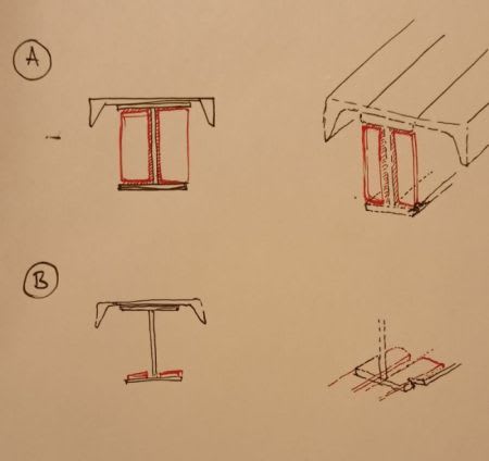

Thank you for the replies. I should've made it more clear that the trolley wheels ride on the bottom flange of the S10, hence the need for a repair that still allows movement of the trolley along the monorail. If this was just a regular beam, I could weld a plate to the bottom flange to bridge the damage and call it a day.

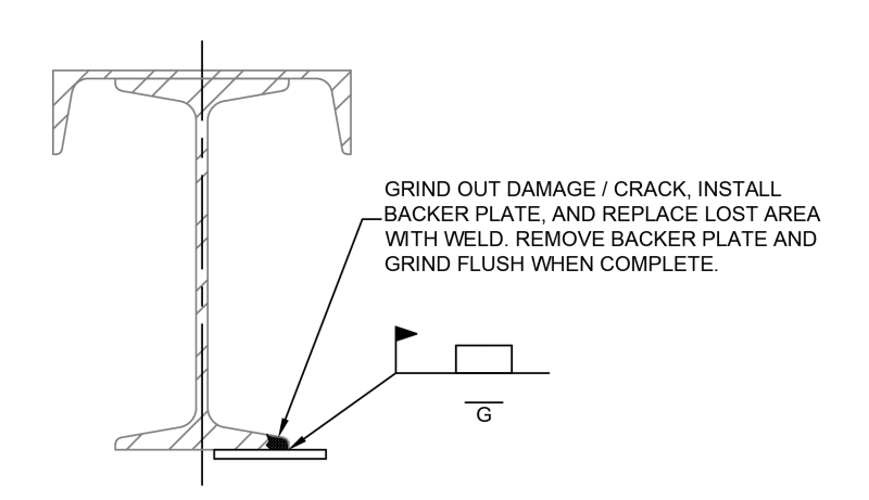

Another repair possibility. Would anyone find this problematic? I'm sure it'll be challenging for the welder but so would splicing in a new section.
The first task would seem to be quantifying the reduction in lateral and vertical capacity, and then determining if the reduction is critical. It most likely isn't, considering the location of the damage. It looks to be at least halfway to the end of the cantilever, so the moment demand should be at most half of the what it is at the support point. A 5% or even 10% reduction in capacity at that location should still give you a much larger capacity to demand ratio than atthe support location.
If you do actually need to repair/restore, it seems to me that cutting out a rectangular section of the bottom flange, just enough to get beyond the damaged area, and welding (with a full-pen groove weld) a piece of the same sized beam, would be less expensive and less apt to have future fatigue issues than a more extensive removal and replacement. There shouldn't be any fatigue issues, since the bottom flange is the compression flange for gravity loads, and the rail is braced for lateral. You may have some limited amount of stress reversal if the lateral loads are high compared to the vertical, but the full-pen weld provides a fairly high fatigue stress limit.

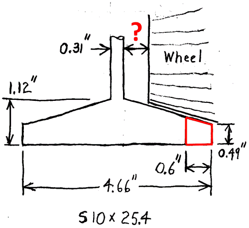

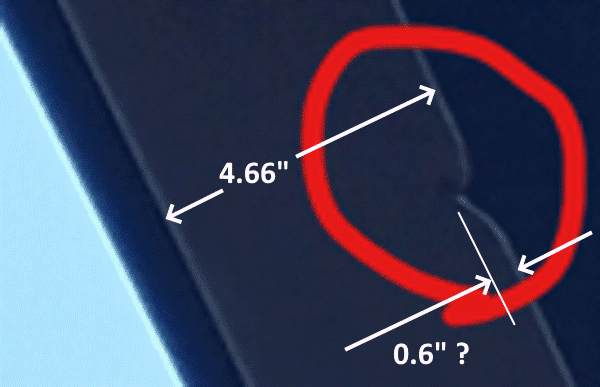

3) Either measure depth of the gouge, or make an informed depth estimate:
4) How does this affect structural properties of the combined S10-C8?
The S10-C8 combination is a "standard" pairing of sections, properties are listed in the AISC Manual:
I = 176 in[sup]4[/sup]
Distance from bottom flange to neutral axis = 6.45 in
From depth of gouge and flange thickness, area of "missing" steel is about 0.36 in[sup]2[/sup] (0.6" x 0.6").
Moment of Inertia of the gouge is approximately 0.36 in[sup]2[/sup] x (6.45")[sup]2[/sup] = 15 in[sup]4[/sup]
Moment off Inertia of the existing combo = 176 in[sup]4[/sup] - 15in[sup]4[/sup] = 161 in[sup]4[/sup] or 91% of an undamaged combo.
Assuming the combo is A36 steel with allowable bending stress of 24 KSI, derate it to 24 KSI x 91% = 21 KSI.
If bending stress at that point is less than 21 KSI, proceed with your proposed flange repair (above).

2) I'll look into this. I caught the issue by looking up at the right place during a routine plant inspection.
3) I'm going to go with the same gouge area you estimated. I believe it's in the ball part.

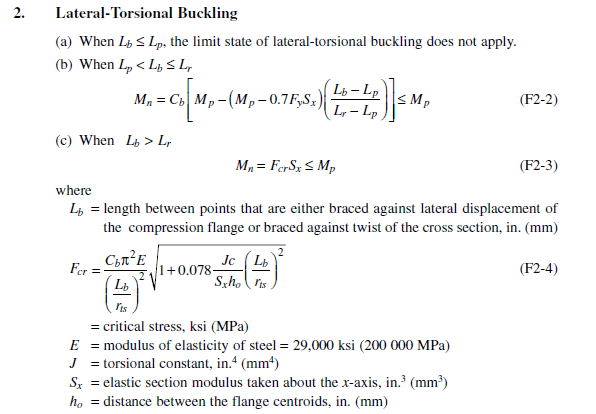

Over lunch, I got into the weeds about unbraced length for overhanging / cantilever monorails and found some interesting eng-tips and AISC discussions.

Not to go too off topic, but I've been curious for a while. I've skimmed the 6th & 7th Ed Spec a few times, but some of it reads foreign to me compared to AISC 360-16. One question I've had for a while is how did the Spec used to deal with lateral torsional bucking? From section 1.5.1.4 in the 6th Ed spec, it looks like you get a reduction in Fb based on l/r. Compared to AISC 360-16, I don't see much about St. Venant torsion J or limiting unbraced length values. I also see 0.6Fy show up many times as a limit. Was calculating the allowable stress Fb for lateral torsional buckling confusing "back in the day"? Or was it easier then?
I'm just used to doing this from F2 (and sometimes F3 & F4) in 360-16, so the old allowable stresses throw me off a bit.
RattlinBog - As you know, 6[sup]th[/sup] Edition came out in 1963... no personal computers, no hand-held calculators... only bulky mechanical desktop calculators, but far-and-away, primarily slide rules. Try calculating anything like the equations you listed above on a slide rule - possible (if you also used paper/pencil for addition/subtraction) but time consuming and error-prone. "LTB" was not even in the daily engineering vocabulary... compression flanges were considered to be adequately "laterally supported" or not. Look in your 6[sup]th[/sup] Edition, Section 2. "Allowable Loads on Beams, General Notes" has a discussion on "Lateral Support of Beams". The allowable spacing of lateral support is given in the Section 2 beam tables.
An example, for A36 steel, what we now call W12x50 has "L[sub]c[/sub]" = 8.8'. L[sub]c[/sub] is the maximum lateral support spacing where allowable bending stress is 24 KSI (0.66F[sub]y[/sub]) for a compact section.
Same beam, "L[sub]u[/sub]" = 19.3'. L[sub]u[/sub] is the maximum lateral support spacing where allowable bending stress is 22 KSI (0.6F[sub]y[/sub]) for a compact section.
Section 2 does have "Allowable Moments in Beams With Unbraced Length Greater Than L[sub]u[/sub]", but not used too often. Basically the allowable bending stress is mathematically reduced as lateral support spacing increases. I used this section a few times where a beam with lateral bracing was not possible. These equations work, if you can put up with it acting like a trampoline... you can see (and feel) LTB actually trying to happen. I walked across one of my designs, HP10x42 used as a beam with 60' simple span and no lateral bracing.
All noncompact sections were limited to 22 KSI (0.6F[sub]y[/sub]) regardless how closely spaced lateral bracing.
In later editions the "Allowable Moment in Beams" graphs were used extensively since the line for any certain beam took into account lateral bracing.

I completely agree with SRE’s approach to the problem you are dealing with. You should also know what steel the existing beam is made of, to assure weldability. I would like to know much more about the size, shape, bent flg. areas, etc. and cause of the damaged area. I think I would try to steal a piece of bot. flg. (maybe the top flg.) from the free end of the beam, about 6 or 8" long to repair the damaged area. A piece of the web would provide samples for testing and mat’l. chemistry, etc. I would prep. this flg. piece, size, shape and edge bevels to match the cutout of the defective flg. area, which would also get beveled edges. Then a couple passes from the underside, back gouge the top side of the grooves, and then fill them in, and grind smooth. This weld could be UT’ed if you wish, although it is primarily in compression. You should probably shore this beam while you are working on it.
Your image shows that the trolley wheel runs on roughly the outer 20% of the width of the flange, and using SRE's analysis of the photo of the damage, it suggests that the wheel would only have about 20% of it's load supported at the widest part of the damage. This would suggest that simply filling the void would not necessarily help, since the issue would be the that small sliver of the flange that would still be supporting the full load of that trolley wheel.
Nevertheless, the image you provided would seem to imply that the trolley wheel would have sufficient clearance for you to weld a plate on the bottom of the flange and then you can fill in the void and have some structural support for the fill as well as for spreading of the load when the wheel actually goes across the void.
