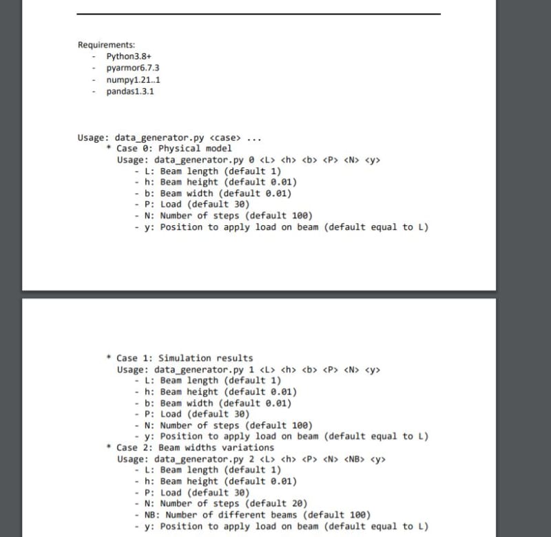

Hello community,
I want to formulate a data-driven calibration model between physics and simulation results. I have an a model encapsulated in an executable program (data_generator.py) that for a load 𝑃 located at 𝑦 = 𝐿, generate 𝑁𝐵 random beam widths 𝑏(𝑥) and computed the beam displacement 𝑤(𝑥) at 𝑁 positions, at locations 𝑥(𝑖) = (𝑖 − 1) ⋅ 𝐿/(𝑁 − 1) ( file attached shows the beam )
I run the two cases (simulation results 'case 1' and physical model 'case 0')
Usage: data_generator.py <case> ...
* Case 0: Physical model
Usage: data_generator.py 0 <L> <h> <b> <P> <N> <y>
- L: Beam length (default 1)
- h: Beam height (default 0.01)
- b: Beam width (default 0.01)
- P: Load (default 30)
- N: Number of steps (default 100)
- y: Position to apply load on beam (default equal to L)
* Case 1: Simulation results
Usage: data_generator.py 1 <L> <h> <b> <P> <N> <y>
it gives me results in file attached. I don't know how to proceed to do a data-driven calibration model. anyone has an idea please ?

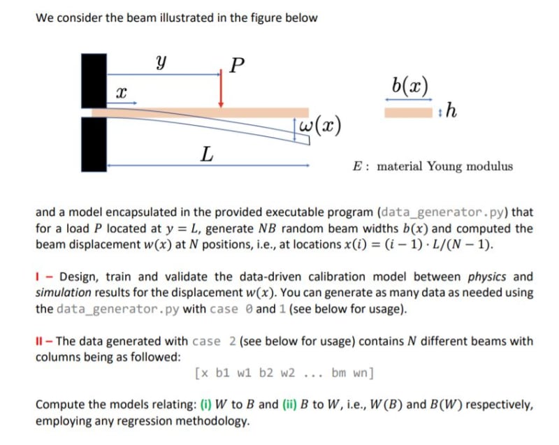

Thanks for the reply, the question is "Design, train and validate the data-driven calibration model between physics and
simulation results for the displacement 𝑤(𝑥)" . What I understood from the question is :
goal : minimizing error for "w(x)" between the two models
but concerning the algorithm, should I search for something similar of "minimizing error" ??
Thanks [dazed]
hahah I though about both ML and RMSE error. But I think I will use RMSE and see how it will work. But the problem is how to preceed , I don't know if the concept of data-driven calibration model will require to do a mechanical model of the beam ... ??

So, it seems to me that you would start by looking in Roarks' Formulas for Stress and Strain, find the simply supported beam with a concentrated load, parameterize the equation with unknowns and then use least squares fit to the data and solve for the unknowns.

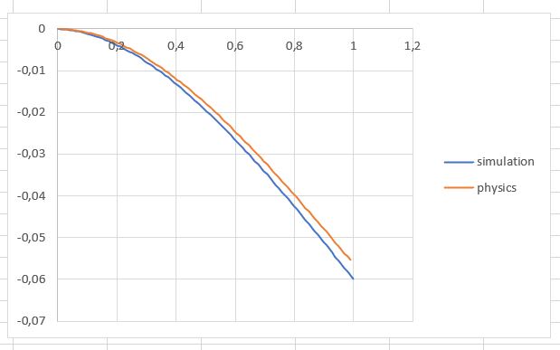

another point, I wanted to see the results of the two model here's the results
according to results I thinks maybe it's not preferable to use linear approximation
No, to your last question, those are all the independent inputs. And no to your linear model, since your graph is obviously not linear, so model fit will fail there. Again, consult Roark; his deflection equation uses a cubic, so I would at least start with a quartic polynomial and use the data to find the 5 coefficients; hopefully, you'll wind up with a mostly cubic polynomial with perhaps a weak quartic contribution. You actually have to solve for 7 unknowns, since elastic modulus and moment of inertia are presumably unknown, as well.

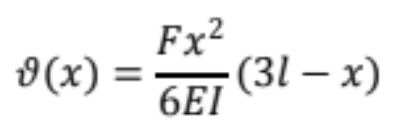

here's the analytical expression of w(x)
