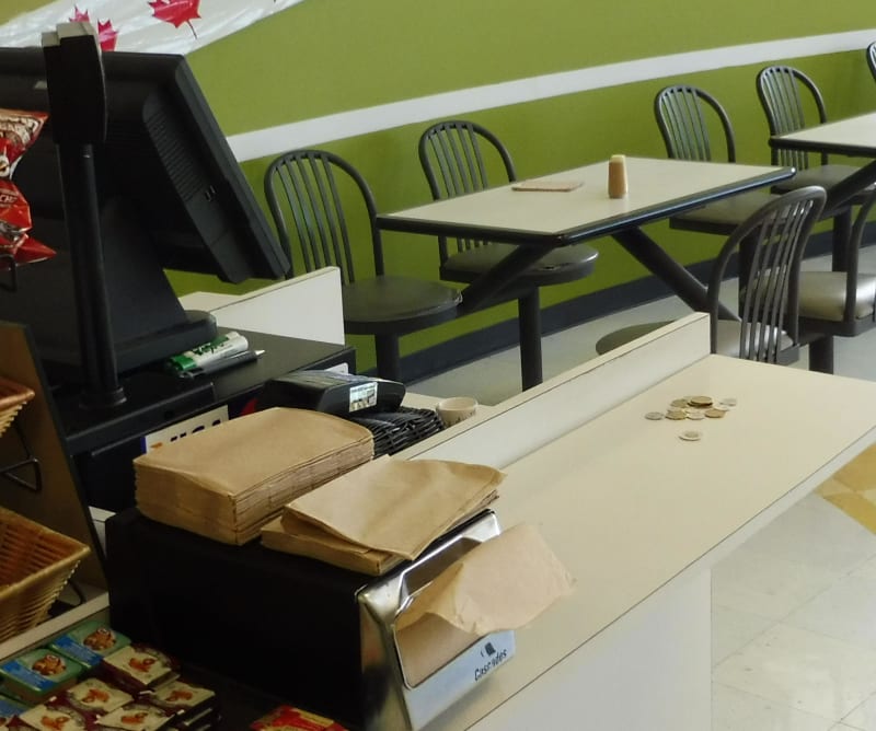

A couple of years ago, I was on a contract with a company that was obsessed with GD&T, among other things. They were very good at it. On my last day, I photographed the cash register in the lunch room. It was not always manned (personed?). People were taking coffee and muffins and leaving their change on the counter next to the register. There is a mindset that makes things work.

Drawoh, I was at a factory on contract and same thing, very picky on drawings, and I think it was like your example in the cafeteria.

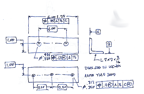

I was thinking more about this, and how obviously GD&T boosts price when working with small quantities of low-accuracy parts.
Take for example a bracket sawcut from a short length of angle iron. Drill two holes in one side of it. While GD&T says I should place a true position on the holes, so as to provide bonus tolerance for the hole locations, do I really want to pay for the vendor to build a functional gauge? Or put it on the CMM table? Fine, it's your money, lose business in the price of your product. I just added cost using GD&T here.

You have just been asked to quote price and delivery for two pieces as illustrated above, drawn on a napkin or on a piece of scrap paper out of my recycling bin. You need somehow to meet the tolerances I have specified. How thoroughly would you inspect this thing?

Oops! I missed attaching datum[ ]C to the .438/.375 hole.[smile]
JHG
Forget that example. Imagine the same part, with no holes, A and B datums, as attached, and datum C as one end. There are no other dimensions, save an overall length. (but for some reason I have 3 datums)
What would you make of that, if you're a vendor? Do you charge extra, based on not knowing exactly what kind of madness you're about to have to deal with? Take it one step farther - if I have a mandate, that if I have datums, I SHALL reference some feature TO those datums, have I just built in a cost? Did I need that "all over" surface profile tolerance - which is one of the simplest "default" specifiers, for the type of parts that we produce?
Well if it didn't have positional tolerances, I'd use a tape measure and/or a dial caliper.
Unless you have a tape measure that consistently evaluates true position tolerances...which I do not.

solid7,
I deliberately went overboard on that thing. The drawing completely specifies what I want.
When I took my GD&T course, the instructor stated that the datums describe the manufacture and inspection tooling. There ought to be a fixture with pins for the 3/8[ ]holes. On the other hand, when the part arrives on my loading dock, I don't know and I don't care how you fabricated and inspected it, or even if you inspected it! If I specify tolerances that are marginally within the capabilities of your process, you need to inspect everything, and possibly factor in a scrap rate. This part is inspectable with a plastic scale from a dollar store.
